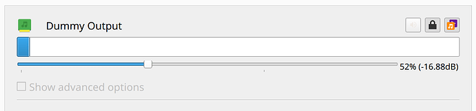

No sound (Dummy output)
Just installed Zorin OS 18 on my iMac19,1 and realized I am not getting any sound... it is detecting music being played in a browser tab but I'm not really sure where to go from here.
I've tried a few solutions here and there from the forum with no luck.
I am fairly new to Linux and I'm not all that tech-savvy in general, so I apologize in advance for any missteps

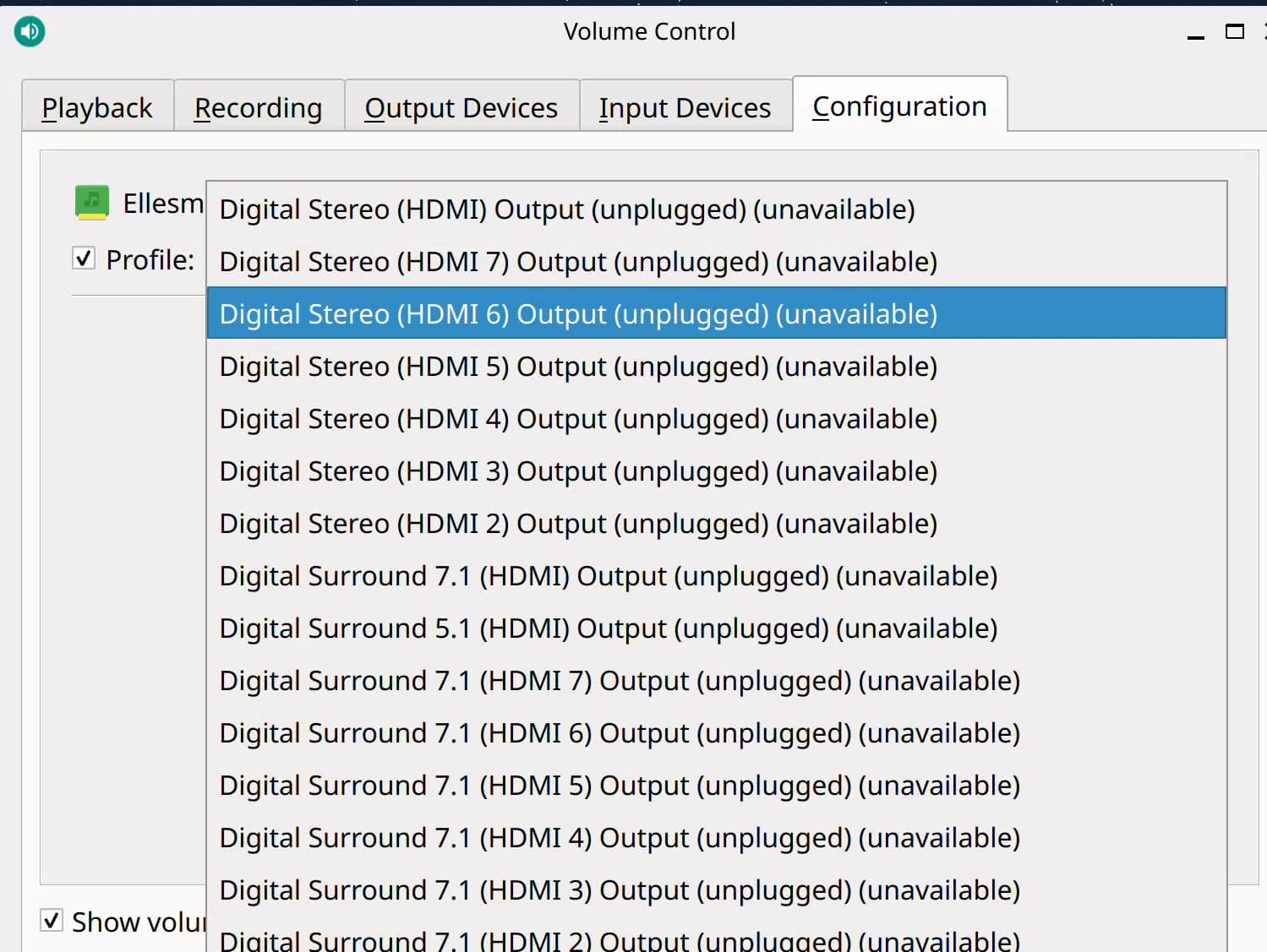

Attempts with the following commands resulted in
sudo apt-get install kernel-source =
E: Unable to locate package kernel-source
git clone GitHub - egorenar/snd-hda-codec-cs8409: Linux Kernel Sound Driver for Cirrus Logic CS8409 (e.g. for iMac27 5k)
(said "command git not found, but can be installed with: sudo apt install git", so I did)
E: Unable to locate package egorenar (Alexander Egorenkov) · GitHub

Did another search and still comes up with the same solution.
" Ellesmere HDMI Audio on Ubuntu 24.04 for iMac19,1 requires a specific kernel module to enable audio output through the AMD Radeon RX 470/480/570/580/590 GPU.
The snd-hda-codec-cs8409 driver from the GitHub repository egorenar/snd-hda-codec-cs8409 is the recommended solution for fixing the "Dummy Output" issue.
Steps to Install:
  1. Install required build tools and headers:
sudo apt update
sudo apt install -y linux-headers-generic build-essential git gcc-13
  1. Clone and compile the driver:
git clone https://github.com/egorenar/snd-hda-codec-cs8409.git
cd snd-hda-codec-cs8409
make
sudo make install
  1. Reboot the system:
sudo reboot
After rebooting, audio should appear in the sound settings. If audio stops working after a subsequent reboot, the module may not be loaded automatically. To fix this, ensure the module is loaded at boot by adding it to /etc/modules :
echo "snd_hda_codec_cs8409" | sudo tee -a /etc/modules
:white_check_mark: Note : This driver is specifically designed for iMacs with the Ellesmere HDMI audio chip and is confirmed to work on Ubuntu 24.04 and 25.04. The issue is not with ALSA, PipeWire, or PulseAudio configuration, but with missing or incorrect audio codec support in the kernel.
Did you install git first with:
This worked!! Thank you so much :slight_smile:
