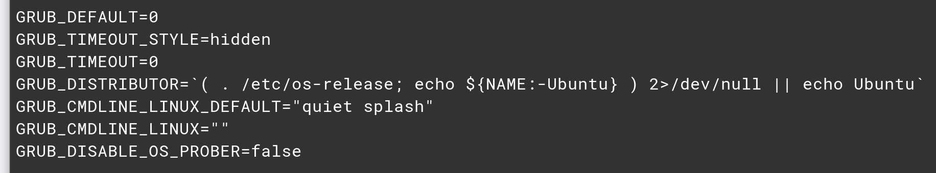

Okay, let's try the Following:
Open the Terminal and type sudo nano /etc/default/grub to work on the GRUB Config File. Then You should see a white Textblock:
Add snd_hda_intel.dmic_detect=0 to the Line GRUB_CMDLINE_LINUX_DEFAULT so that it looks like this:
GRUB_CMDLINE_LINUX_DEFAULT="quiet splash snd_hda_intel.dmic_detect=0"
(Don't forget the Quotation Marks!)
Then press ctrl+o to save the Change, Enter to confirm and ctrl+x to exit and come back to the normal Terminal Overview. There type sudo update-grub to make affect the Change. Don't forget that! Without it, it will not work. Then reboot.

Thanks for the suggestion but I'd tried this previously. My Grub file currently reads:
GRUB_DEFAULT=0
GRUB_TIMEOUT_STYLE=menu
GRUB_TIMEOUT=10
GRUB_DISTRIBUTOR=`( . /etc/os-release; echo ${NAME:-Ubuntu} ) 2>/dev/null || ec>
GRUB_CMDLINE_LINUX=""
