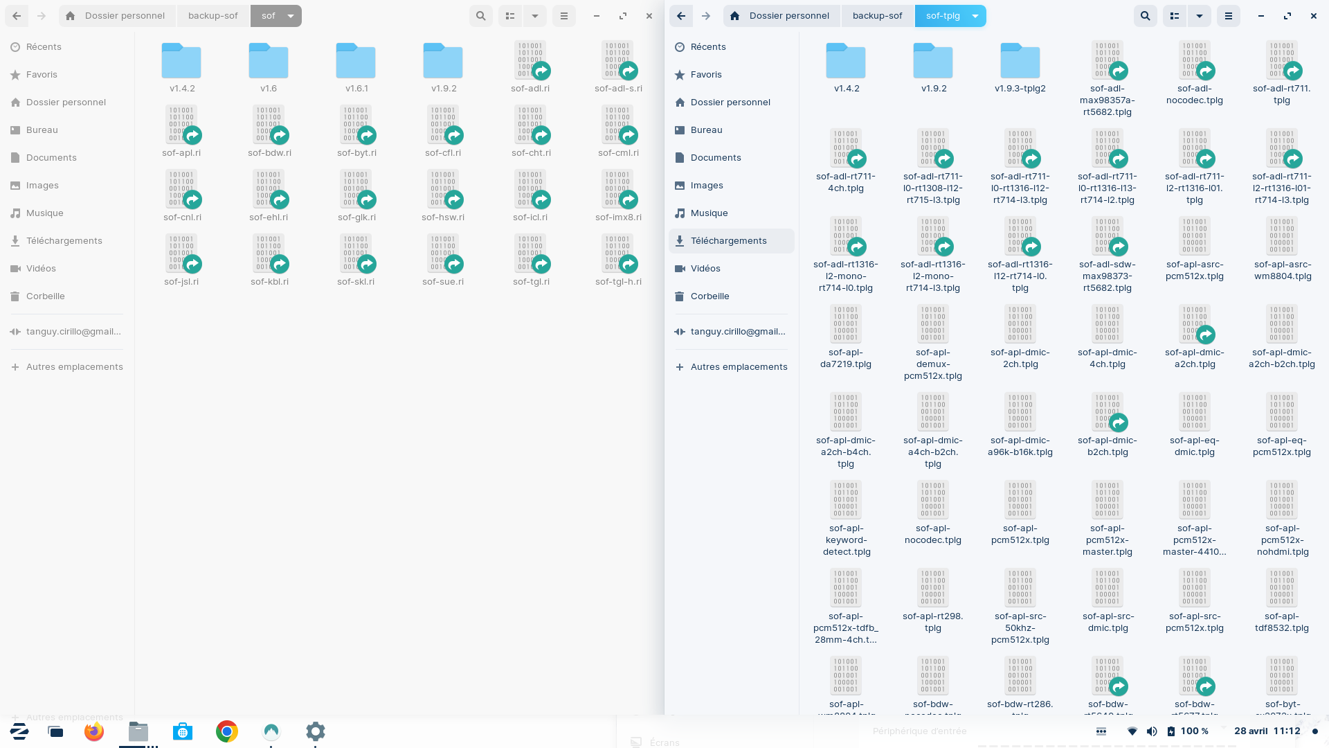

I've followed the tuto with the manual install because I didn't manage to run the install.sh.
I don't really know if I've follow well the tuto because now my folders look like this and the output is on "fictive output" and the sof output doesn't display anymore.
Originaly, there were more files, maybe i should try to copy them inside and change the folder name? :thinking:
So I just did the step if it doesn't work and now I still don't have the sof output but I have a better thing I guess. However, the audio still doesn't work :sweat_smile:
