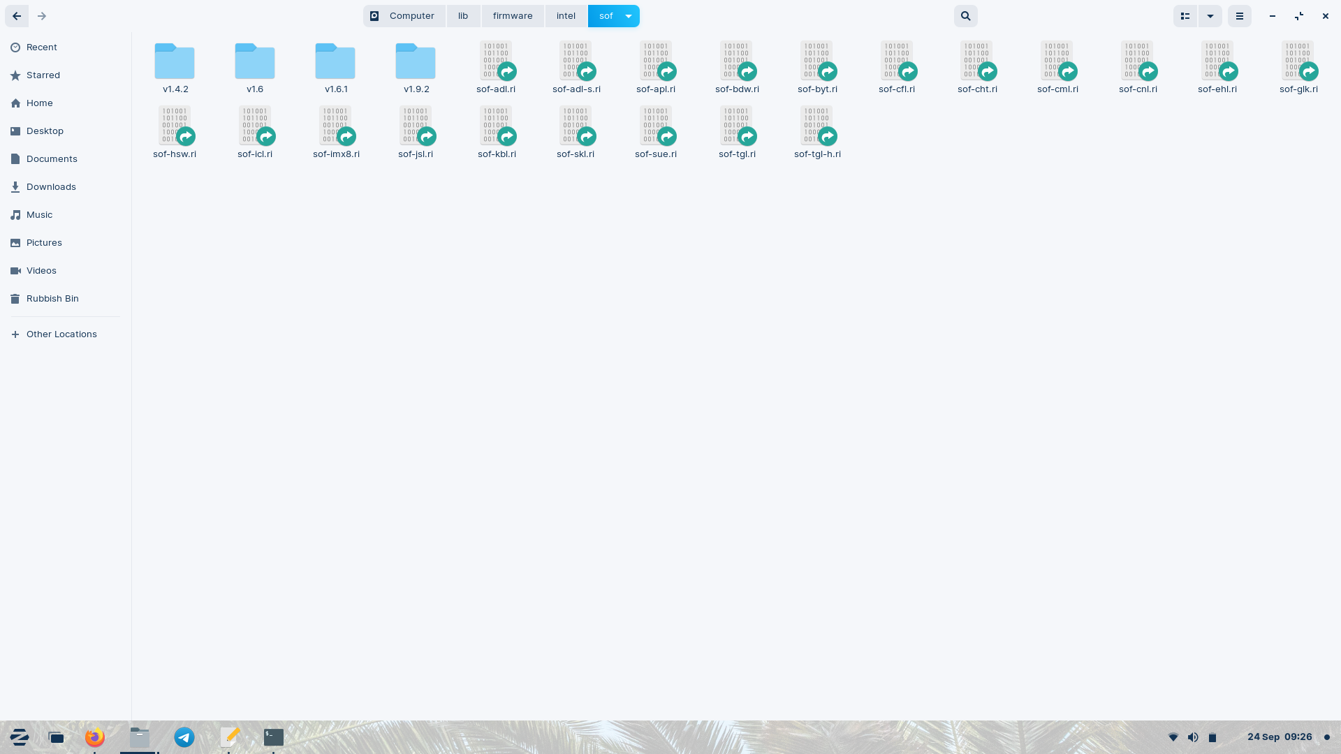

Can you check if you have an Intel Directory in /lib/firmware? You should... but the output says something is missing...
i just checked the lib/firmware/interl to see if it actually existed and found it appears to already contain certain versions of the Sof-firmware
albeit it not as new. to save any more possible heartache for everyone else helping would it be the worst thing to continue with the next step in the initial how to audio page even if the SOF-firmware isnt the latest version? or would that process generally run under the assumption youve successfully installed the latest version and proceed onto the next copy and paste step.

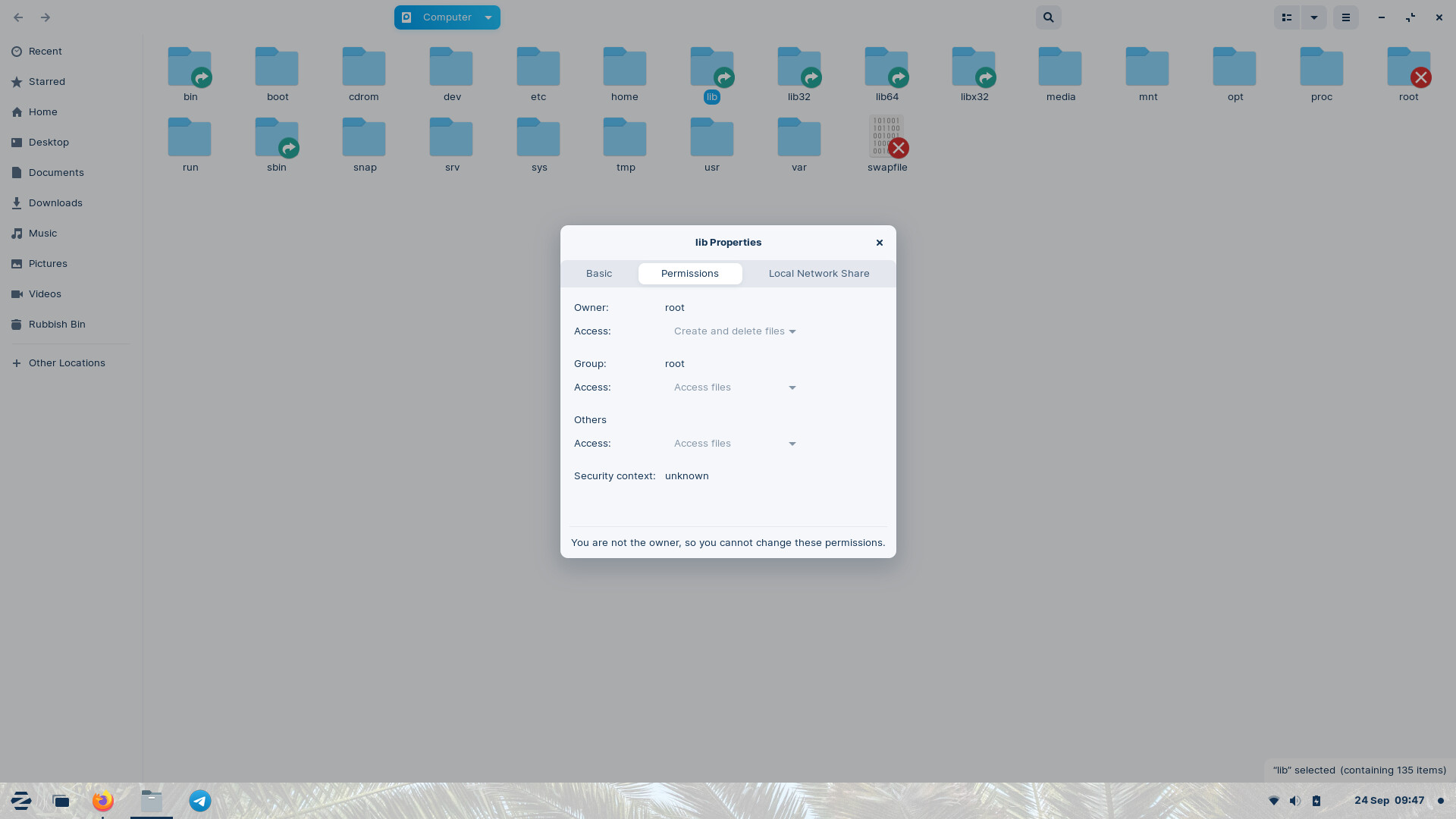

Im keen to keep learning about this system, as daunting as it seems i feel it still gives a whole load more freedom than windows or the chromeOS her chromebook came with. Just had a look at this permissions of the lib folder and youll see in the privileges to it it says im not the owner, im guessing that is what the sudo is for in terminal, essentially telling the computer you are the owner ive put in the password now let me change things?
I wonder if you can now adjust the sound levels to your needs using alsamixer
i.e. type alsamixer in terminal.
You can see that the file structure in GnuLinux is very much an organized tree - unlike Windows OS which is scattered and completely illogical.
We start with Root, which is the base level and the one directory that contains all directories.
When you are within this directory, you will always need Root Permissions or to be 'elevated to root privileges'.
SuperUserDO is sudo. Superuser means elevated privileges. DO means "do this."
Moving along all the branches of root, we see /opt, or /etc, or /lib but there is one Special Branch on the tree: /home
In that directory, lives the User Account. Opening /home will show folders that are named for each user. Often, there is just one user but there can be more if you set up multiple users.
Once you enter that username folder you are now under the permissions of That User and Their Ownership.
And when you enter your own /home/$USER directory, it is under your ownership.
Root Directory also has a home of its own since Root has ownership and that owner is the administrator (Whoever it is that has the root password). This directory in the root folder is simply called /root.
When in any Users Directory - Yours - Another Users - or Roots, you must use the password associated with that Users Privileges and ownership in order to make changes.
System-wide Settings and Software will be in Root - under /etc, /opt, or /usr
(e.g. /usr/share/applications)
User specific settings and software will be in their Home Directory, usually in /.local
(e.g. /.local/share/applications)as well as in /.config.
