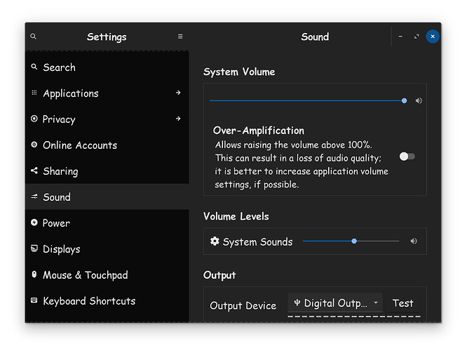

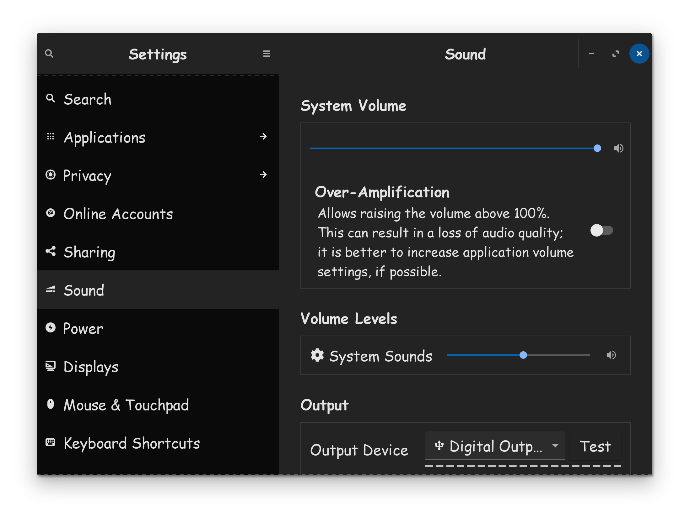

I just found and installed the Pulse app and when I went to "Volume Control" I noticed the the System Sounds slider bar was all the way to the left to the Silence position and I can't make it move. Could this be the problem?
Could You post a Picture of this?
