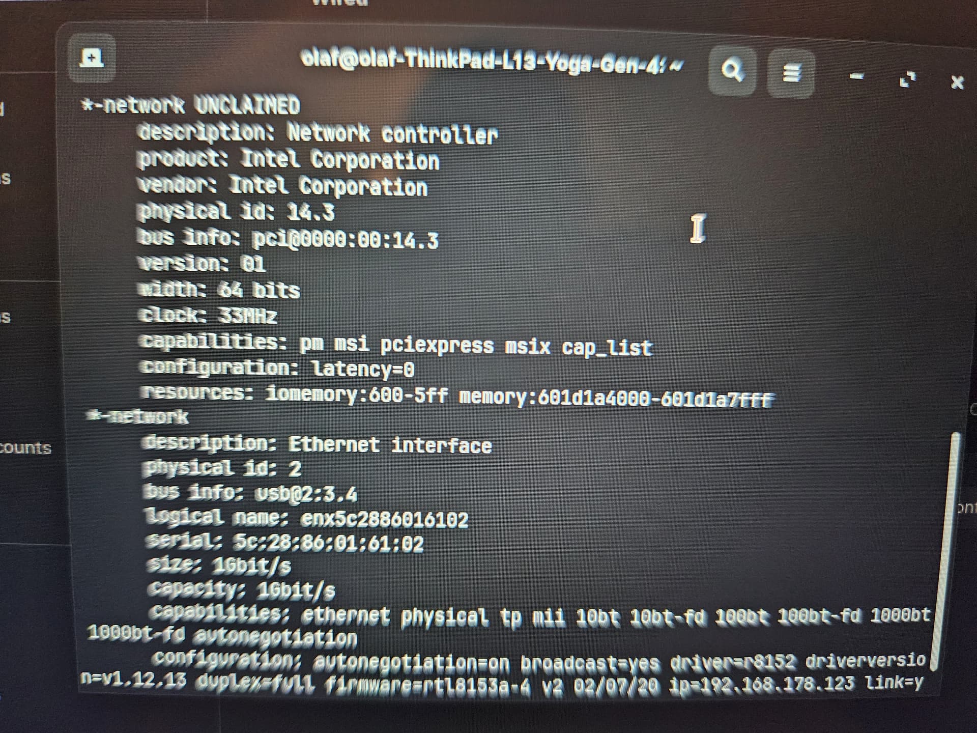

Also in Pop! OS, when you run the
sudo lshw -C network
command, what comes back from that? Does it identify the driver needed?
The fact that your screenshot in the first post states it is unclaimed means the wifi card is recognised but it needs a driver.
