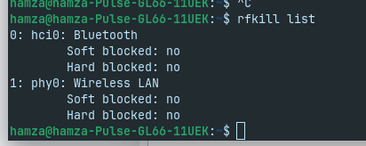

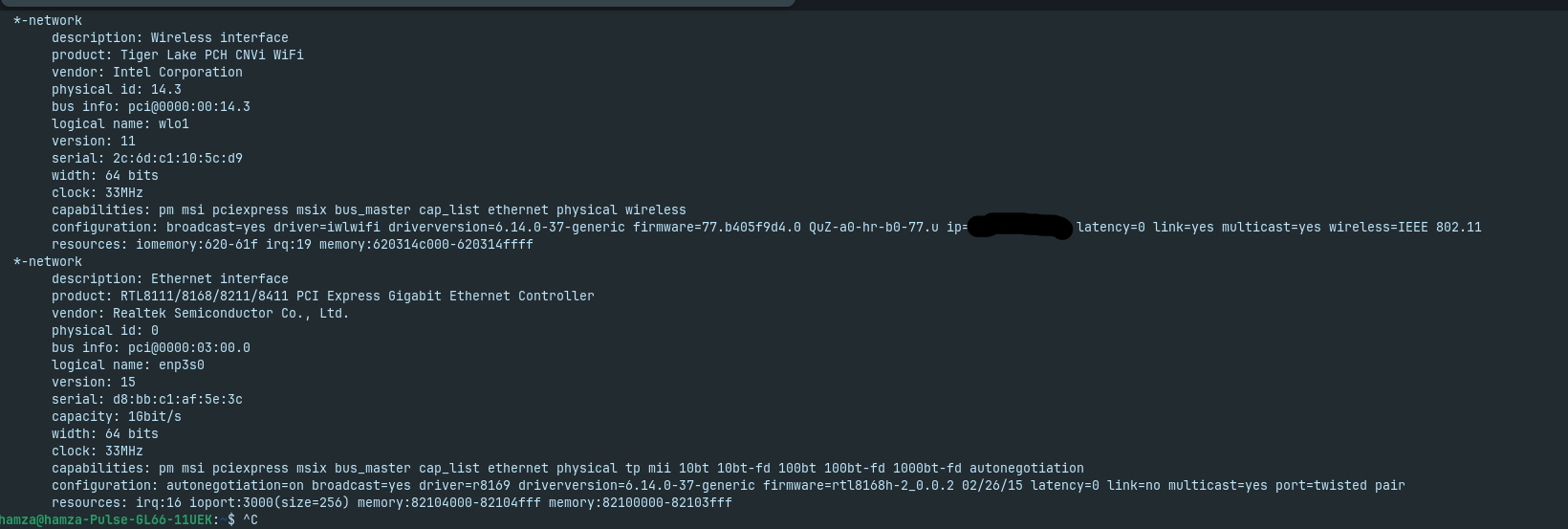

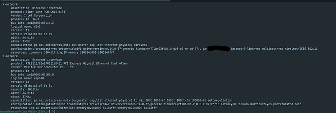

  • Could You post the Output of sudo lshw -C network and rfkill list please?
for the first one
and second one

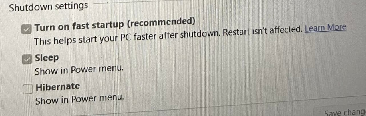

  • But Fast Start-Up in Windows is enabled:
    (the first Option)

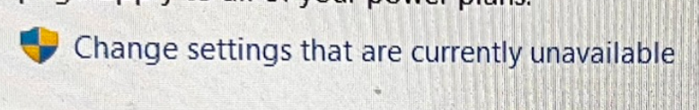

To disable it, click above on:
Then the Option will be changeable.

  • Secure Boot and Fast Boot are already disabled. So, that is fine.
  • Fast Start-Up in Windows is also disabled now. So, fine too.

Your device (tiger Lake Intel) shows that the driver is loaded and attached.
Broadcast is "yes."
So, does your computer have a physical switch, on the keyboard, etc, that sets Airplane mode or Switches Wifi off at the switch?
These are pretty common for quickly cutting off access on notebook computers, due to access on shared networks.
If that switch or key has accidentally been bumped... You might not be aware of it blocking your Wifi.
