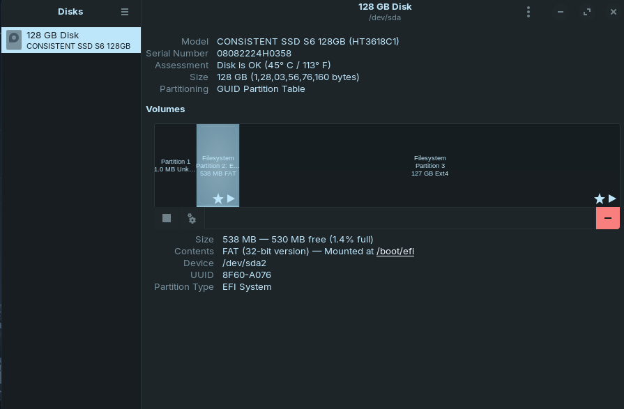

Here is a screenshot of disks app :

I would suggest to set Your BIOS to UEFI because from Your Disks Pictures I can see that the Partition Sheme is GPT and with the EFI Boot Partition this should hopefully work better.
