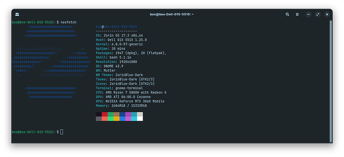

What is your terminal output for:
uname -a
Try using Ventoy instead of Balena Etcher.
Linux box-Dell-G15-5515 6.8.0-57-generic #59~22.04.1-Ubuntu SMP PREEMPT_DYNAMIC Wed Mar 19 17:07:41 UTC 2 x86_64 x86_64 x86_64 GNU/Linux
