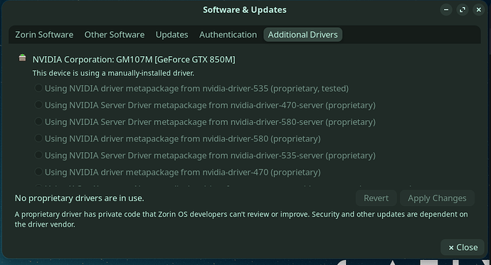

Nvidia drivers greyed ot in Software and updates
Driver options are greyed out in software and updates. I think I might have screwed it up by canceling while it was downloading one of the options. any fix? I can't even uninstall steam because it says the driver is missing.
Hello,
try this
ubuntu-drivers list
and
sudo ubuntu-drivers install nvidia-driver-580
after that you will see drivers listed correctly with choices in the Software & Updates App
you can also read this to understand how it work
Did You scrolled down to the End of the List? Because I see that there is more. Also I see at the Top under Your Gaphics Card Description ''This device is using a manually-installed driver.'' which means normally that a Driver was installed that is not on the List.
So, You should scroll down the List.
Thanks :slight_smile: this seems to have worked
