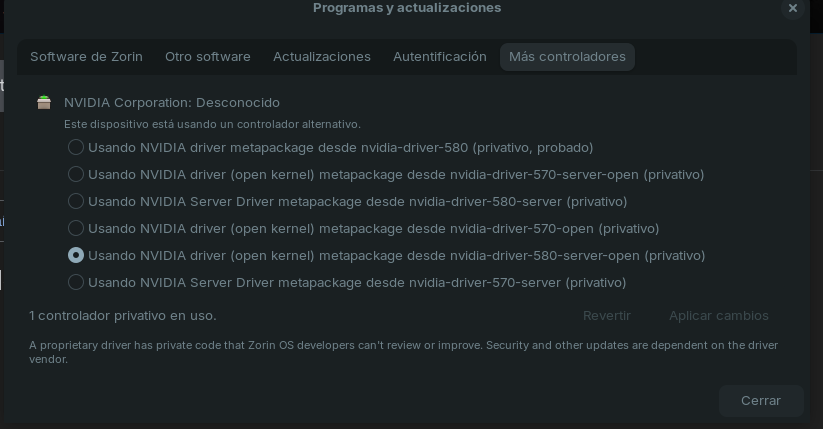

I re-installed Zorin 18, by removing the Zorin 17 OS, but the problem still persists that my graphics card is not recognized. I have installed the latest packages, but the kernel is still version 6.14 something.
I still have to do the steps described here.
I shall also try improving the kernel, as described by @Forpli and the linked guide around the Christmas days. I shall then also install Zorin on my laptop and see if I can start switching towards Linux.
In Zorin 18, are there still others steps to do check for errors with the NVidia not being recognized as a video card? In case you need information about my system once again, let me know.
