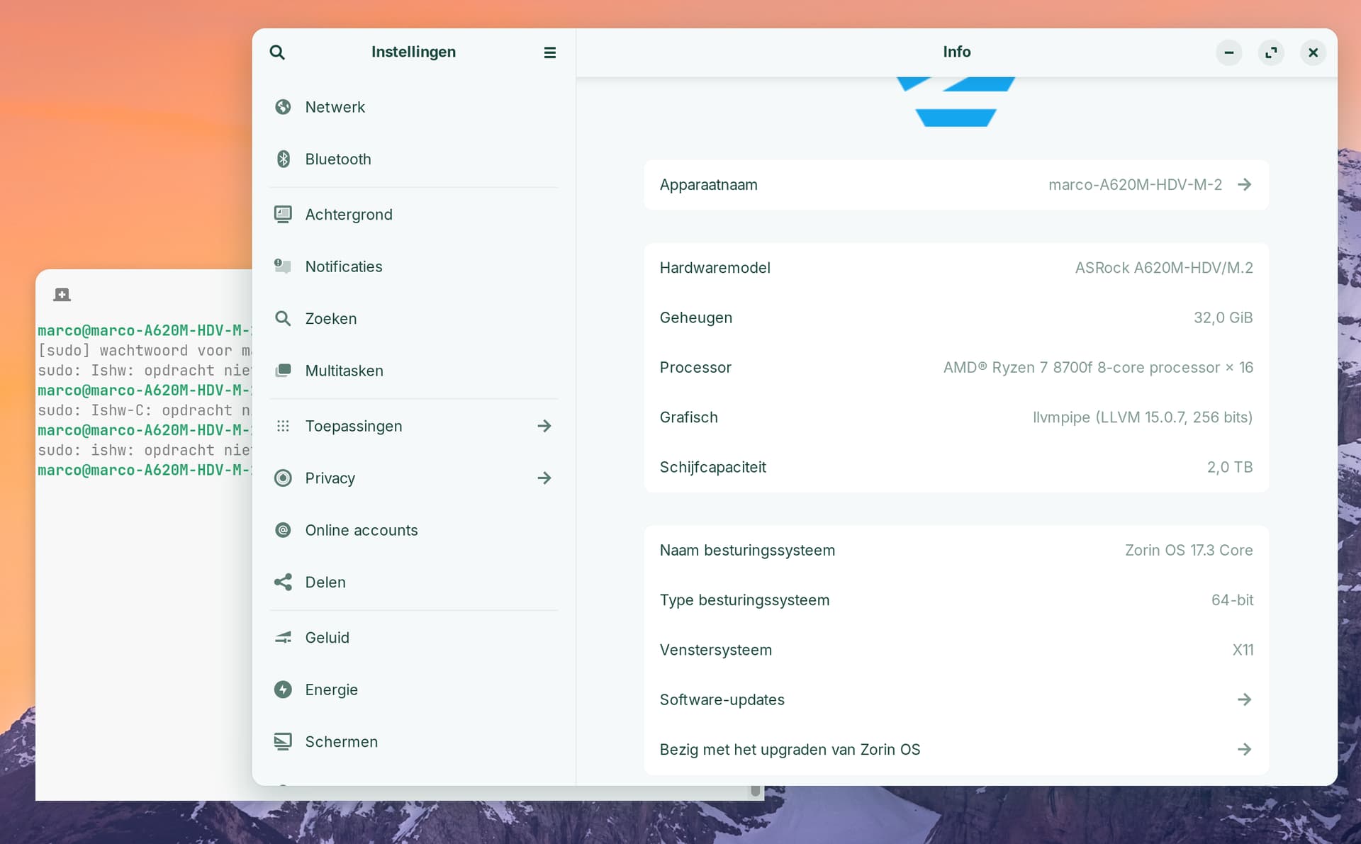

I have recently installed Zorin OS on a pc. After the install of Zorin OS, alongside with Windows, I noticed that pc on Zorin is still not able to produce sound, whereas the same PC, is perfectly able to do when booting it up in Windows.
First, I thought the problem came forth from the tv with the embedded sound system not being properly recognised, though Zorin was able to start the pc in right pixel setting. Then I checked the properties of pc and then I found out, that the Graphics didn't mention Nvidia at all, but llvmpipe instead.
I already did most of the steps from here, though i dont know for certain if I can select the right drive metapackage.
Can anybody help to get this card working or tell me how to diagnose this problem further? As a new user of Linux, I don't know anything about solving hardware issues with Linux at the moment.
Activate NVIDIA Graphics Card - Zorin Help. I did all steps here.
Set Up Sound - Zorin Help, until the HDMI step.

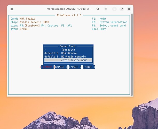

Do you know what soundcard your PC has?
I am guessing from replies re Graphics card (NVidia GeForce RTX 5060) maybe your PC is quite new, maybe requires a later kernel than 6.8 for both graphics and sound.
Can you open terminal and type:
alsamixer
In alsamixer, hit F6 to list/select soundcards.
What soundcard/s are listed? Post a screenshot here.
In alsamixer, hit F5 to show All sound channels (both capture and output). Post a screenshot here.

I did the command nvidia-smi in the terminal and it confirmed that Zorin isn't able to communicate with the video card. I also performed the other command, but the response was: command not found.

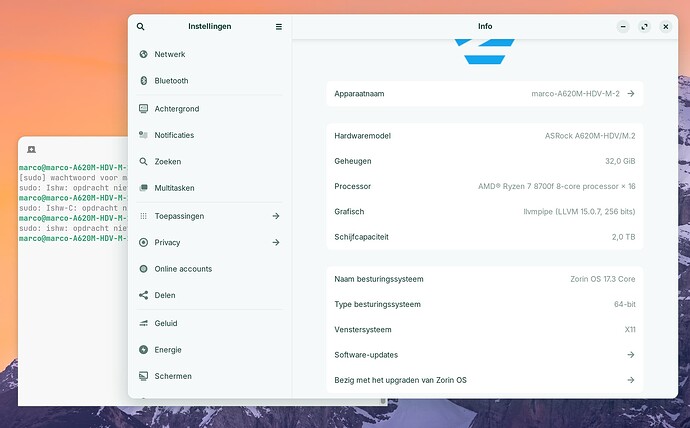

Zabadabadoo, as requested, a printscreen from my system in the terminal with alsamixer. Strange that the pc does somehow know there is a Nvidia card for hdmi sound, but it cant recognize the rest. I have also added a screen shot of the other specs of my pc.
The pc is from a small company in the Netherlands, but they use hardware from known brands. Its a decent/good gaming pc that will hopefully last 8 years before complete replacement or hardware upgrades are needed to keep up with the average games.

I see it. Only the Nvidia HDMI sound is seen by alsamixer, no other soundcard.
Maybe trying a newer linux kernel on the existing Z17.3, or trying a different Distro with a newer kernel may reveal something. Release of Z18 is probably some time away.
