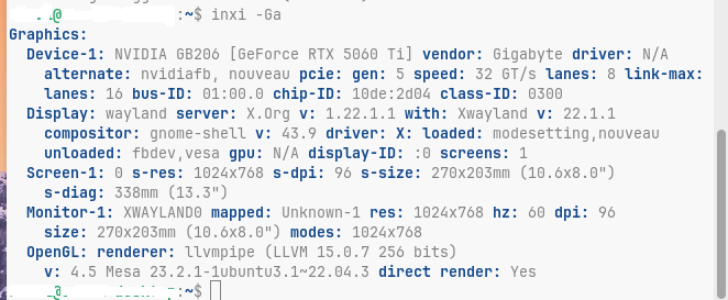

I can't get working RTX 5060 Ti in Zorin OS 17.3. NVIDIA Drivers not working.
Which driver are you using?
Also; post the the output of the last command.
sudo apt install inxi
inxi -Ga

Drivers installed but not working.

First on Zorin the Wayland is not that evolved. People with NVidia cards urges to switch to Xorg.
secondly I will try previos driver to see if it works with them.
You can take a look at this threads. But ubuntu 24 uses a newer kernel.

Not working for me even if i switch to Xorg. I also disable Secure Boot in BIOS. I'm stuck at 1024x768 resolution.

The card should work with nvidia-570-open. Perhaps it would be better for you to use also a newer kernel with your up-to-date hardware. You can install a newer kernel in Zorin or switch to a distribution that uses a newer kernel.
