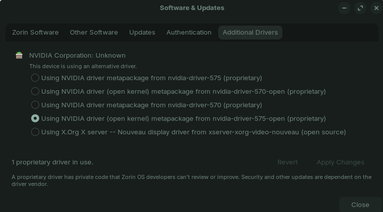

  2. Install Open Kernel Driver
    Install the driver with open kernel modules:
    sudo apt install nvidia-driver-575-open nvidia-utils-575 nvidia-settings

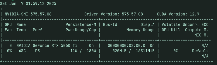

  3. Verify Installation
    Check the GPU status:
    nvidia-smi
    glxinfo | grep "OpenGL renderer"
