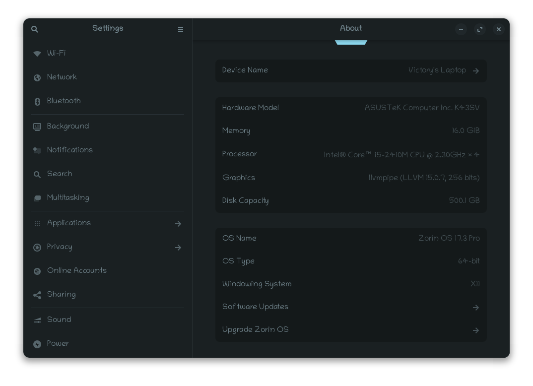

So basically I installed my Nvidia driver before and it worked, I even did some gaming and it worked perfectly fine just yesterday but now I just booted up my PC and saw that my resolution was all messed up and my driver stopped working. Now my laptop uses LLVMPIPE instead of the driver I installed. Please help me :sob:
P.S I've also tried reinstalling the driver but I keep getting errors :sob:

nvidia driver 390
Already using Xorg
The driver was working before and then it just stopped
My pc has only the Nvidia Geforce GT540m, it doesn't have an intel driver at all... and i was running driver version 390

Proprietary Nvidia driver 390 don't work with the normal 6.8 kernel of Zorin 17.3. It only works with kernel 5.15 or when you add kelebek333 ppa. Otherwise you can use nouveau driver for your nvidia card when you are no gamer and don't need the performance.
I don't think i have the PPA installed

Thanks it works now. after adding the PPA i deleted and reinstalled Nvidia drivers and it works.
