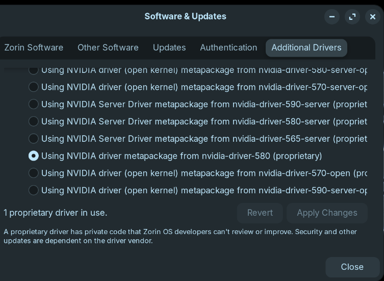

What about installing the Nvidia drivers in the Software & Updates / Additional Drivers?
Thats how I do it personally. :smiling_face_with_sunglasses:
