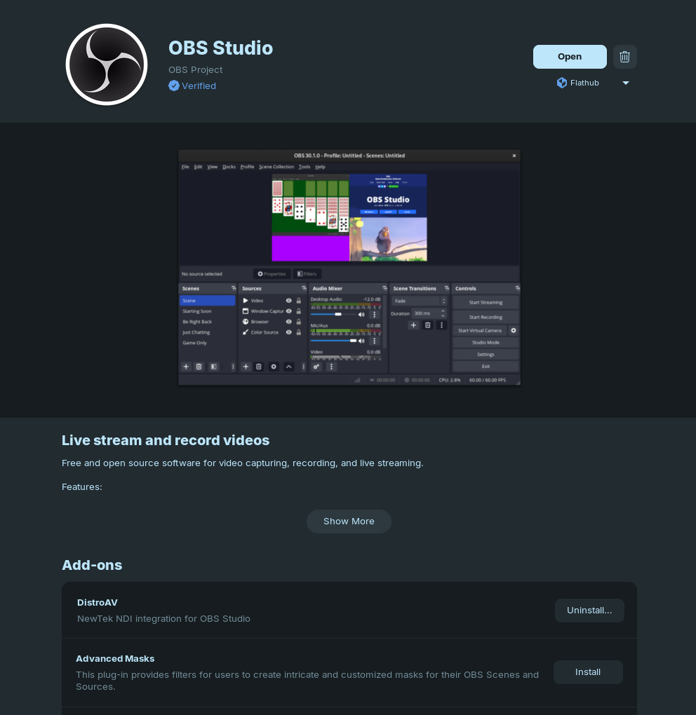

I am currently experiencing an issue enabling NDI in OBS. I have installed the latest version of OBS from the official GitHub repository, but the NDI functionality does not appear to be working as expected.

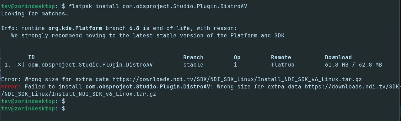

As part of the setup process, I needed to install DistroAV. I have attempted multiple installation methods, including the Flatpak package, deb package, and compiling from source; however, none of these approaches were successful.
When installing via Flatpak, I consistently encounter the following error: “Error: Wrong size for extra data.”

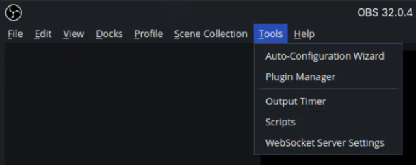

When installing via the Debian package or by compiling from source, the installation completes without any reported errors. However, after installation, there are no visible NDI settings or options available within OBS.

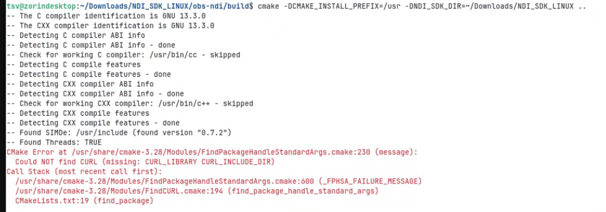

Then each command, one at a time: git clone --recursive https://github.com/Palakis/obs-ndi.git

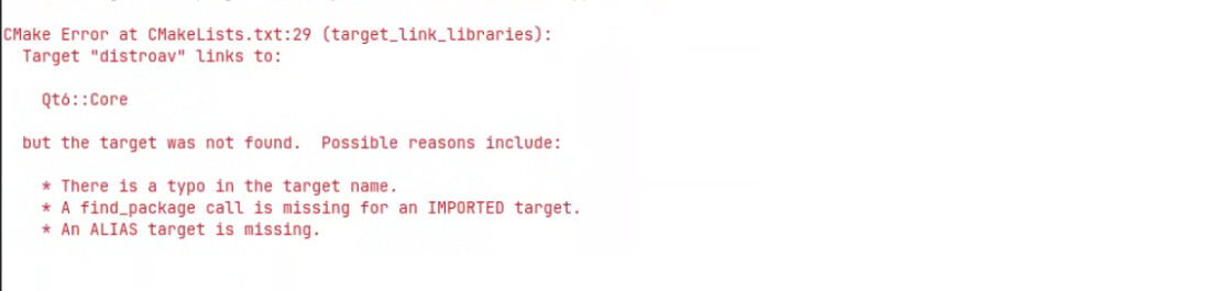

Based on research, the issue appeared to be resolved by installing libcurl4-openssl-dev. However, after installing the package and re-running cmake, a different error surfaced, this time related to DistroAV.
