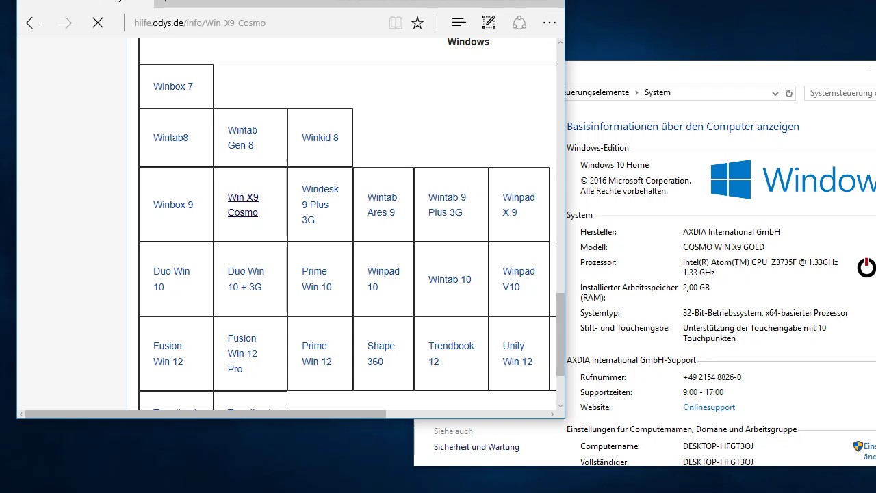

In the meantime, take a look here:
Just had a quick read..
A guy called Rufus writes about his experience with installing Ubuntu
on an old version of the Odys MyBook 14, six year ago.
He complains about the touchpad (the touchpad on the new MyBook is also complete rubbish), the US keyboard disguised as a german keyboard by keybutton swapping (same goes for the new one), and the small flash memory (32 GB on the old model).
So clearly I am not the first to attempt a Linux installation on an Odys MyBook.
