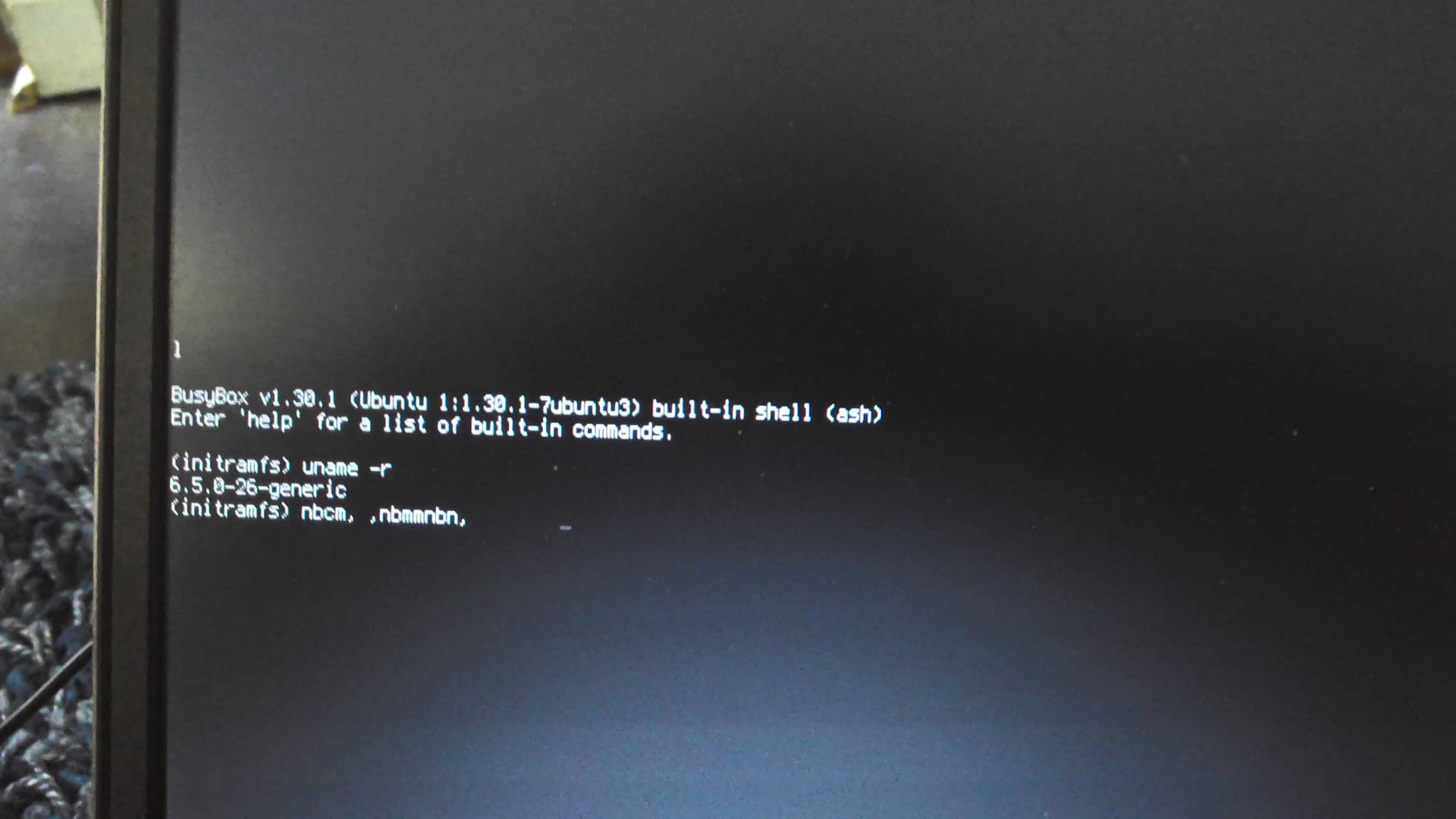

ok i've opened the computer and it's hit me with a new screen -- it's the busybox terminal I think. The kernel number is 6. 5 0-26-generic.
haha yeah if it's bricked it's no big deal, i'll go buy something that can run windows 10 and not have problems running a PS1 game.
this is the image of my computer terminal it opens to -- what's next?

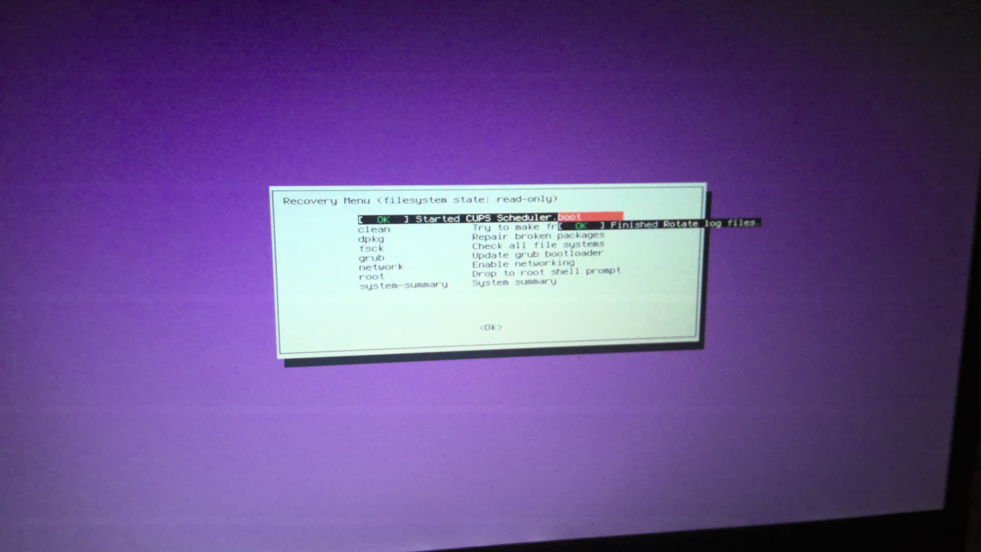

the whole computer is on 6.5 and i'm running recovery mode. will let you know what happens next.
LMAO it's the same dev sda error -- thanks for you guy's help. I'm either going to reinstall an older version or just reinstall windows 7.
aw frick it didn't work
it did a thing
