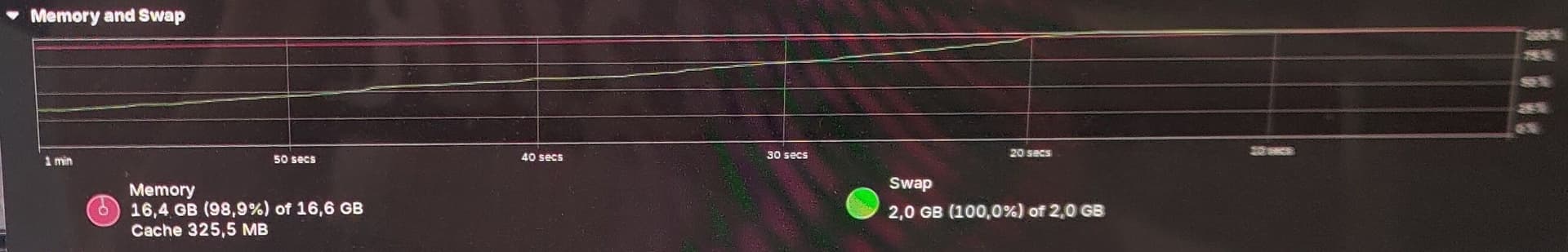

Hello all! While using Zorin OS, I've noticed my system would crash under two conditions were high load would occur: Playing Resonite via Steam, and when rendering a video with flowcut.
After investigating the issue closer, I've noticed that both applications would fill up the RAM, then fill up the Swap, which would then lead to a crash you can only recover from with SysReq+REISUB.

The thing about Swap is that it's more like a safety net, storing away data that isn't immediately needed so that another process can claim that space. When RAM is low, and there are a few processing competing for it, this can give you a little extra room.
But if you find that you're hitting this limit consistently, like when you have one or more programs that are consuming too much RAM too quickly, expanding the amount of Swap space won't help all that much.
Modern SSDs are orders of magnitude slower than RAM, so you'd be running at a huge performance penalty. And you'd be putting your drive under a lot of stress due to the excess data that needs to be swapped in and out.
In these cases, aside from the obvious solution of installing more physical RAM, you could try compressing it through ZRAM. This will effectively increase the amount of RAM, but at the cost of extra CPU cycles, so it's not like it's a magic bullet for everything either:

I do agree with most of the points made: Swap can't/shouldn't serve as an extension to system memory. Upgrading my memory is something I'll need to do in the future, no doubt about it.
I do partially agree about the issue of SSD wear, but I feel that is something the component manufacturer should concern themselves with, i.e. with wear leveling built into the firmware of the SSD.
However, my original concern wasn't using SWAP as means to increase memory, rather to have it as a "safety net" as mentioned by zenzen. The system shouldn't crash if it runs out of memory: It should either terminate the process or have enough "wiggle room" to recover from such a situation.

This really feels like a memory leak to me. Resonite being in early access and not being on consoles at all provides some minor support to that theory, but is of course a long way from proof. (I'm not saying console titles are better; only that console development is EXTREMELY RAM conscious.) Flowblade I can't speak to; I've never worked on video editing software. It would be interesting to see the process list sorted by RAM usage when the system is out of control like this.

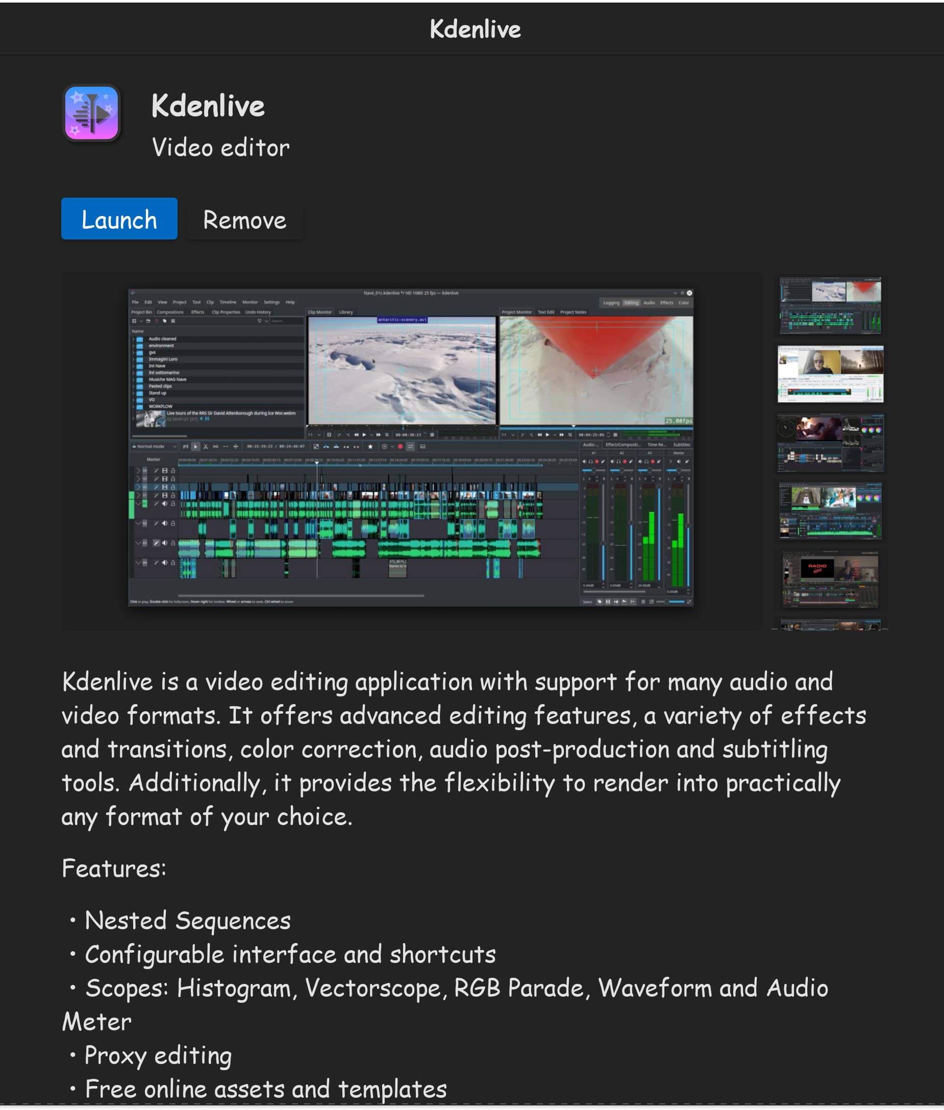

Could you try rendering a project in another editor and see if the same issue arises as well?
