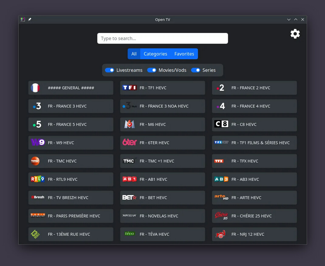

Hi Again Zenzen, I think I`m giving up on open tv. The correctly installed program, with all login and server information when working properly should look like this:

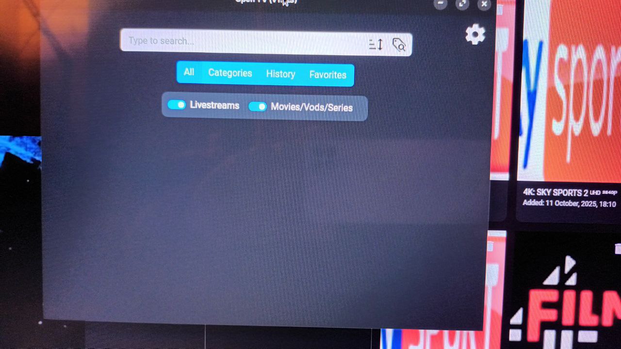

Instead it looks like this:
all settings and login / server information are identical.
it used to look like pictrure 1, before on of the updates broke it.

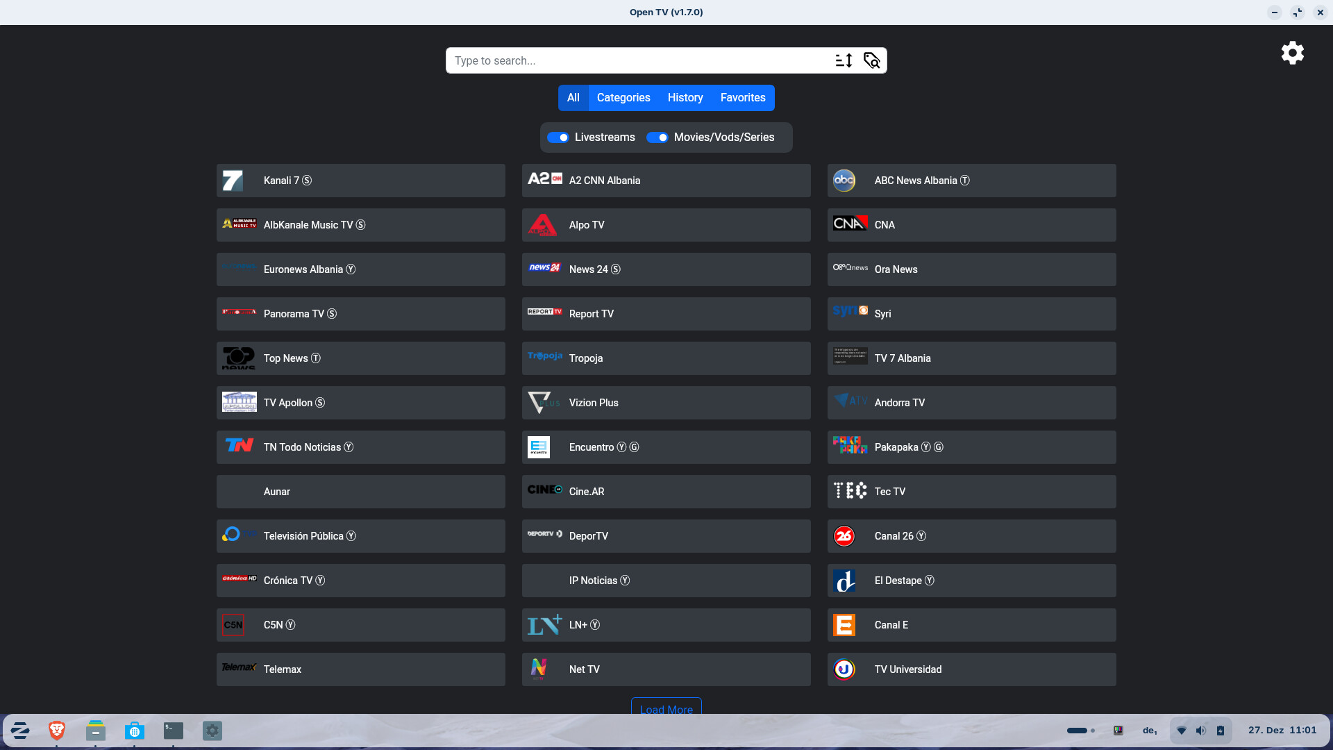

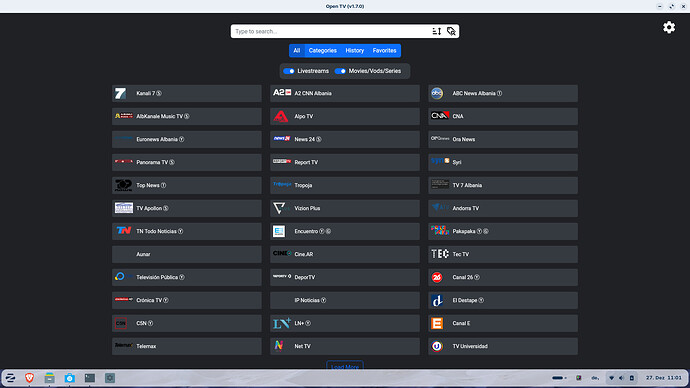

I tested the linked .deb file with version 1.7. of open tv today and together with installing the programs (mpv, ffmpeg, yt-dlp) as mentioned in github it seems to have worked. I have never used such an app before, but after downloading an m3u playlist it looks so:
Tested on Zorin 18 live session
