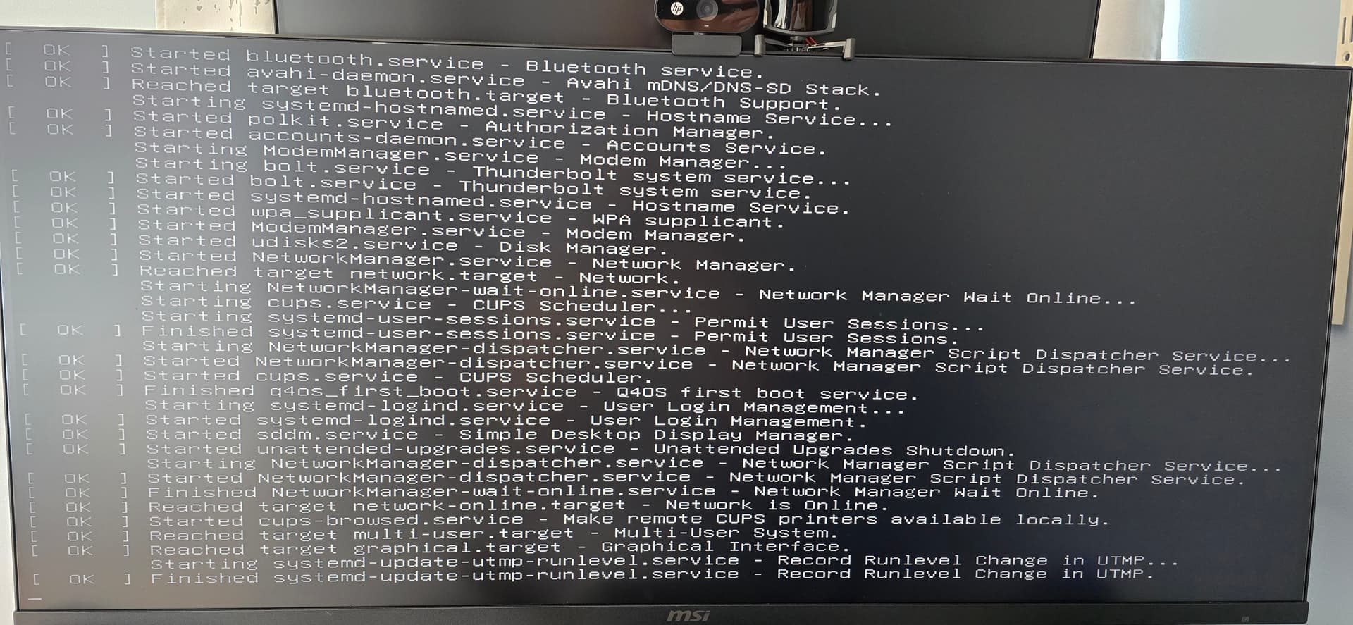

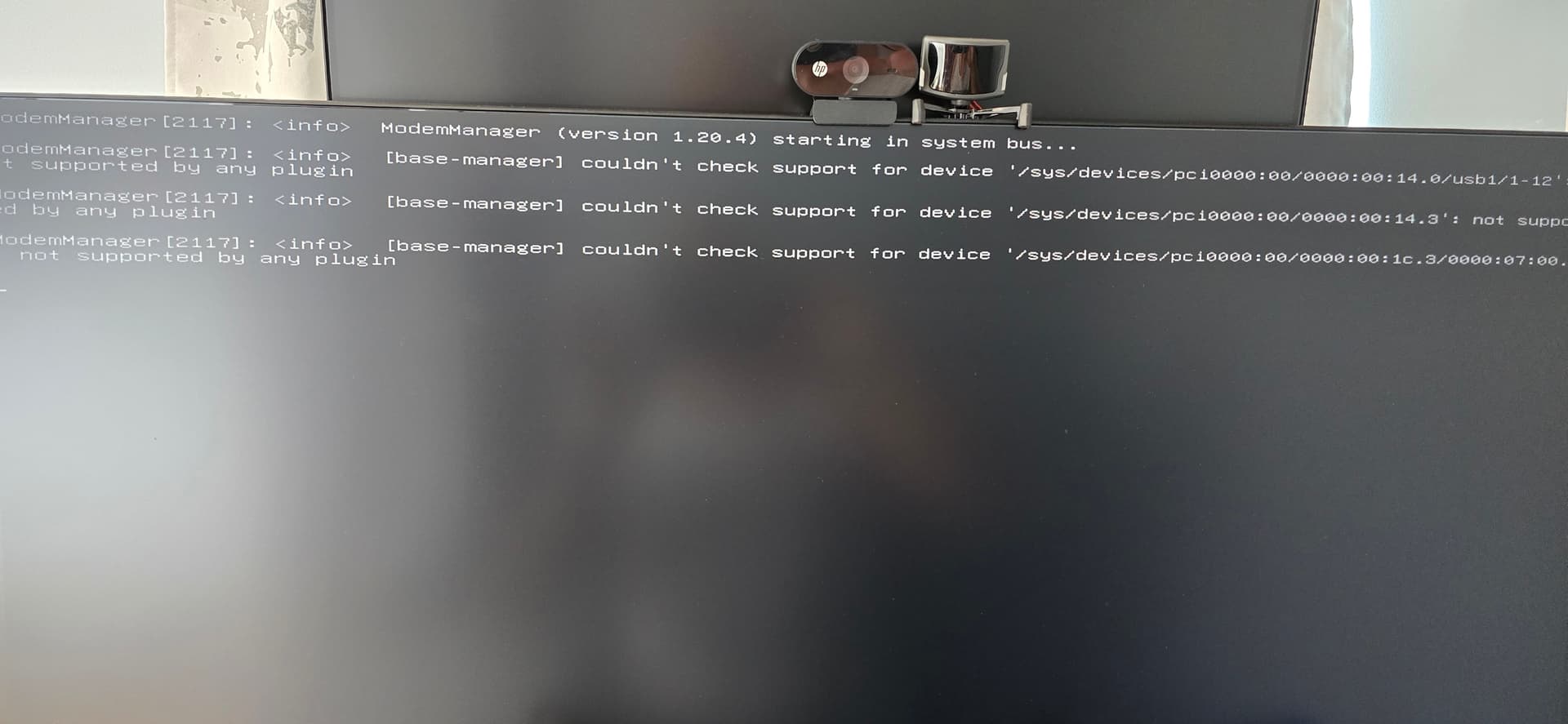

Finally a lesson on endeavour OS on how to install packages. I noticed in the PCKOS Debian screenshot one of the error messages mentions unable to enumerate USB and spotted your bizarre webcams. Was wondering if that might be an issue, but not the issue.
So, Ubuntu 22.04 is not working "out of memory" it is indeed this which prevents me from installing Zorin it seems

I have a webcam and a trackir 5 maybe one or the other that is not supported
