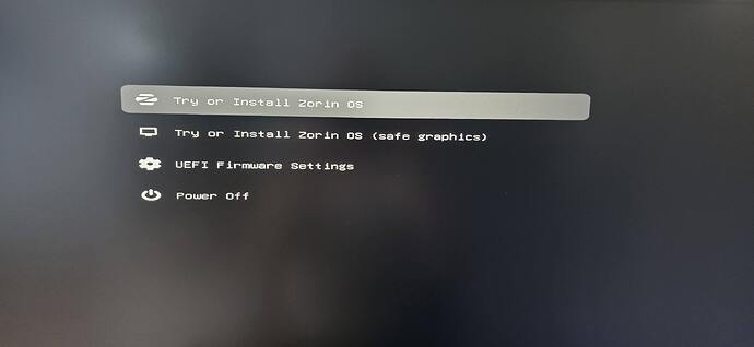

So, I'm trying to install Zorin OS 17.3 on my PC.
But I'm experiencing the "out of memory" issue.
I've disabled secure boot, disabled fast boot, and removed dual boot. I've tried with multiple USB drives. I've disabled "TPM." I've done everything recommended here on the forum (I think).
I have 32GB of memory, a super RTX 4080, and an I7 13700k.
Does anyone here have another solution to suggest?
Thanks.

So, I tried Rufus and Ventoy and the settings you told me to use, and nothing happened: "out of memory."
In the meantime, I tried Fedora and Pop, and they all work.
So, Ubuntu, Mint, Fedora, and Pop work, but not Zorin OS :frowning:
I don't understand.

So I tried to install it directly, but when I click "try" or "install," I get "out of memory," and I can't do anything except restart the PC. I don't see an install option.

I also tried "safe graphics."
