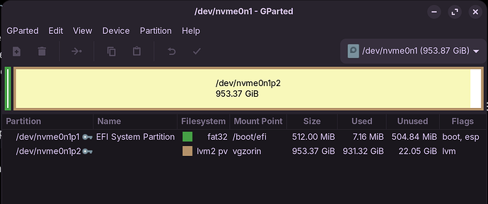

I've tried booting a Gparted USB and a Zorin 18 live session. All options fail. They show a small 500MB partition at the start of the drive and a 973GB partition, but with live session Gparted/Zorin live Disks & Gparted they allow me to resize down to only 953GB with 22GB free space - the slider refuses to drop any lower. There are no intermediate partitions (i.e. I've seen Youtube videos showing a swap partition in the middle of the disk, not the case here), so there is no obvious reason that I should be unable to split the 973GB into two. Any advice would be much appreciated.

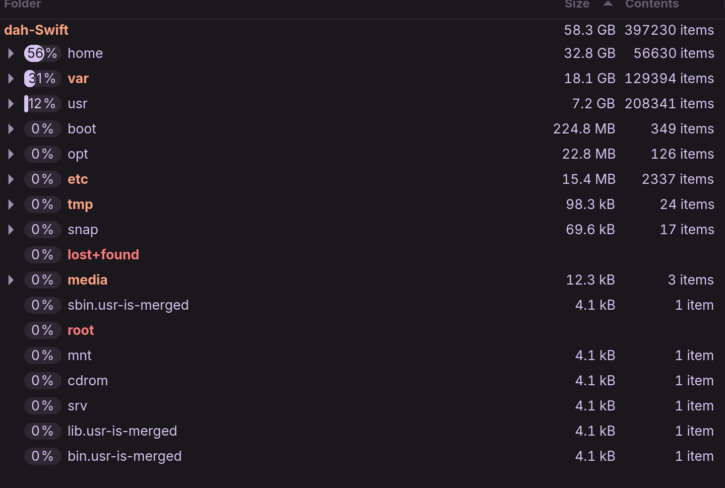

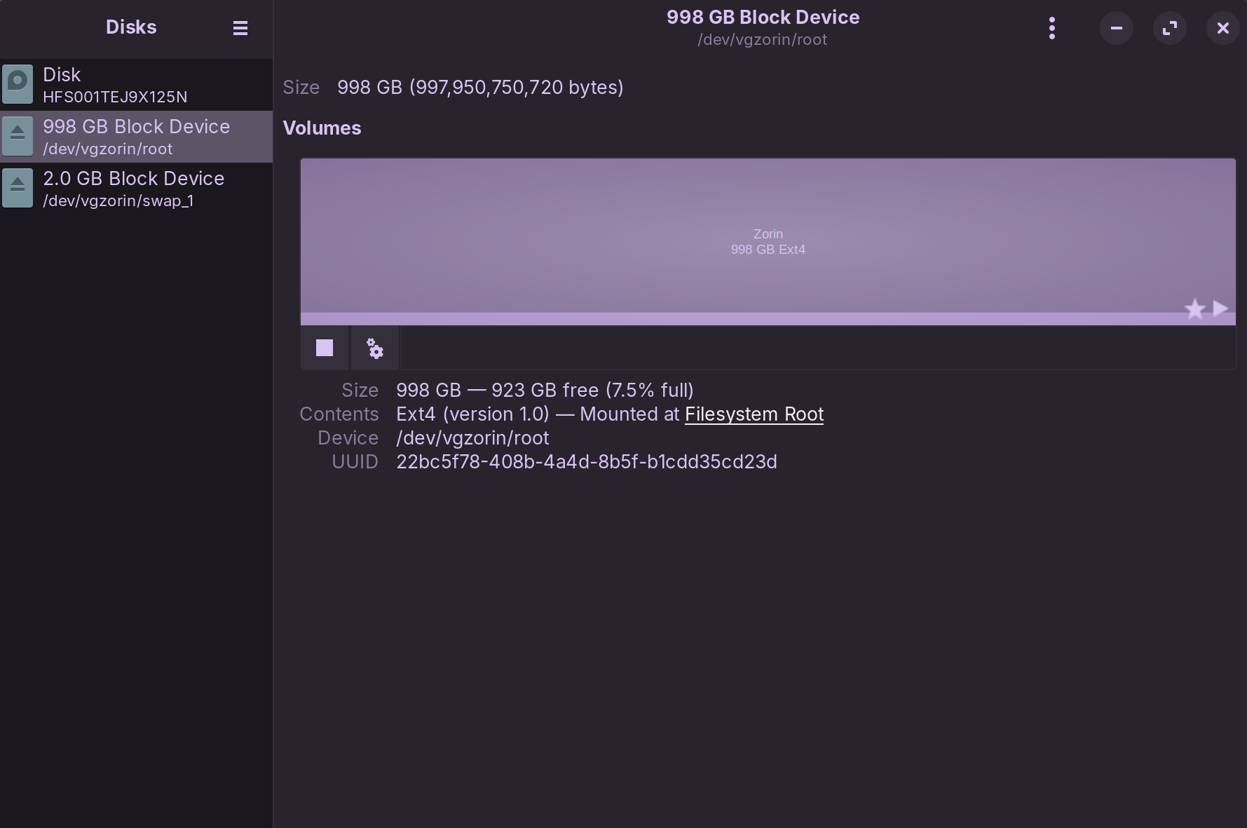

Thanks for replying, Danny. Screenshots of Disks & Disk Usage Analyzer copied, showing less than 60GB of 1TB used. The Gparted screen shows a similar bar with a resize arrow, but it can't be moved left beyond 22GB free, and the left side of the bar, where the half-GB partition sits, can't be moved at all. Looking now at the Gparted image, I see "Used: 931GB", but I have no idea why that is, because there is certainly not 931GB used.
I've been using Zorin for about a month, so it has pretty much the bare minimum of apps plus my Mega data folder.

Looks like you are using LVM. You would need to reduce the size of the root LV (logical volume) with a terminal command (gparted can't do lvm stuff). Then you will have free space to create a new LV in the VG (volume group) vgzorin for other use.
the reference is:
man lvreduce
For example to reduce root to 50G,
sudo lvreduce --resizefs --size 50G /dev/vgzorin/root
I think root LV can't be mounted during this operation, so you need to issue commands from live zorin USB.
After that, you can use lvcreate to make one or more new LVs inside vgzorin for other use. You don't need another partition.
