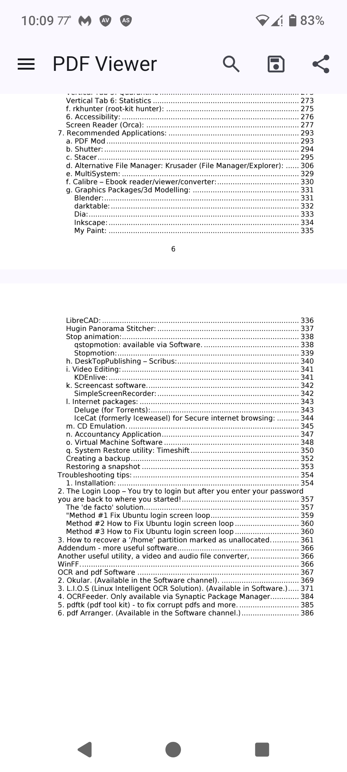

I covered all three possible solutions in the Unofficial Manuals for 15, 17 and 18 under 'The Login Loop':
