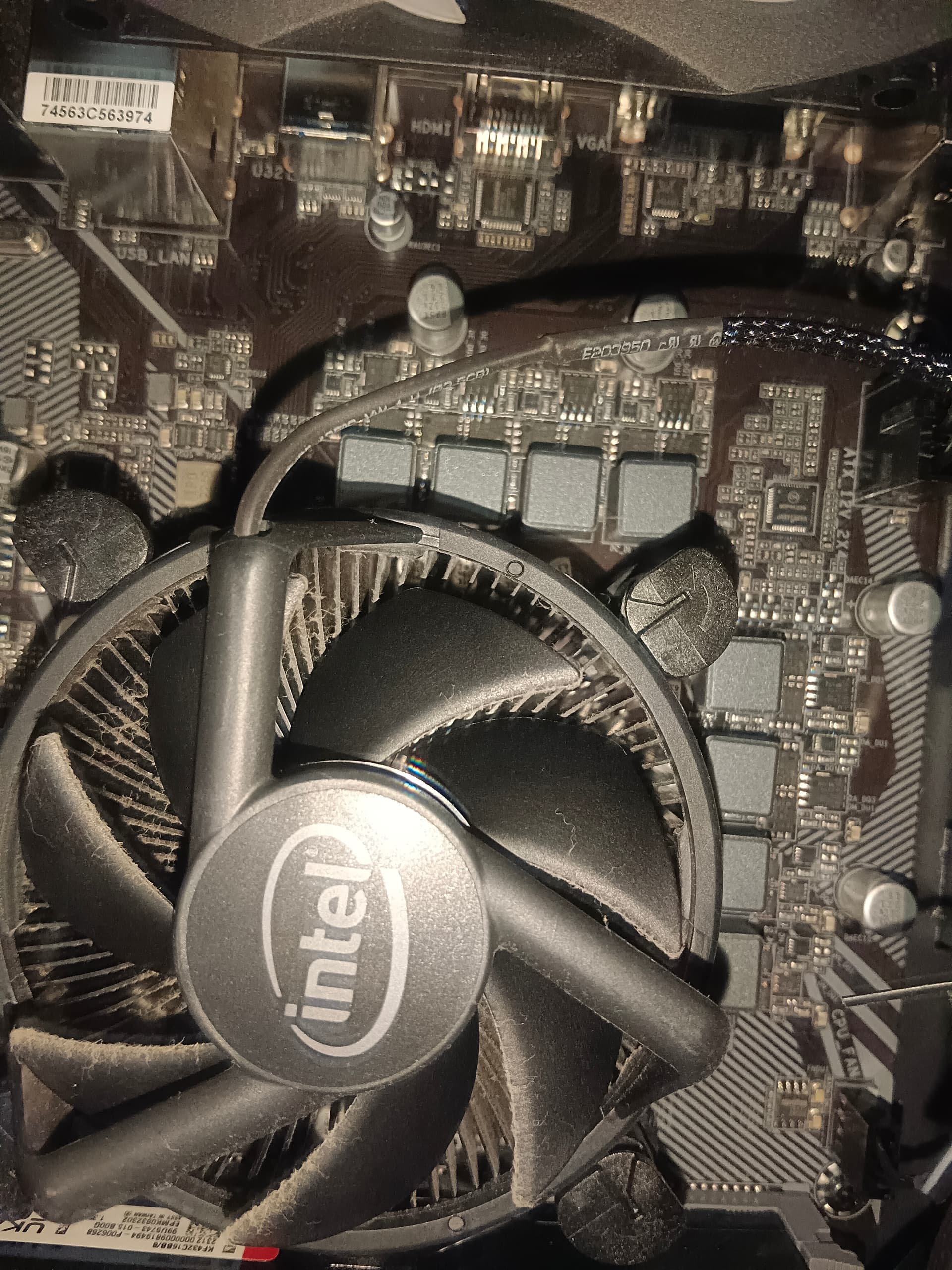

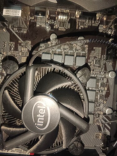

I don't see anything that looks burnt. All I see is some dust here and there (not a lot on every component except the HDD, where there is... quite some dust and... a hair?) and quite bad cable management. I'm no expert in that, but I don't think it's a good idea to have most cables touching the ventilation of the power supply...
Well, the cable that goes into the cpu cooler goes from a black-grayish that doesnt reflect the light of the phone's torch to a suddenly more pure black that reflects a lot the light. I have no clue if this was always like this or not, never took that deep of a look here
