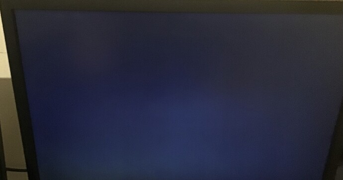

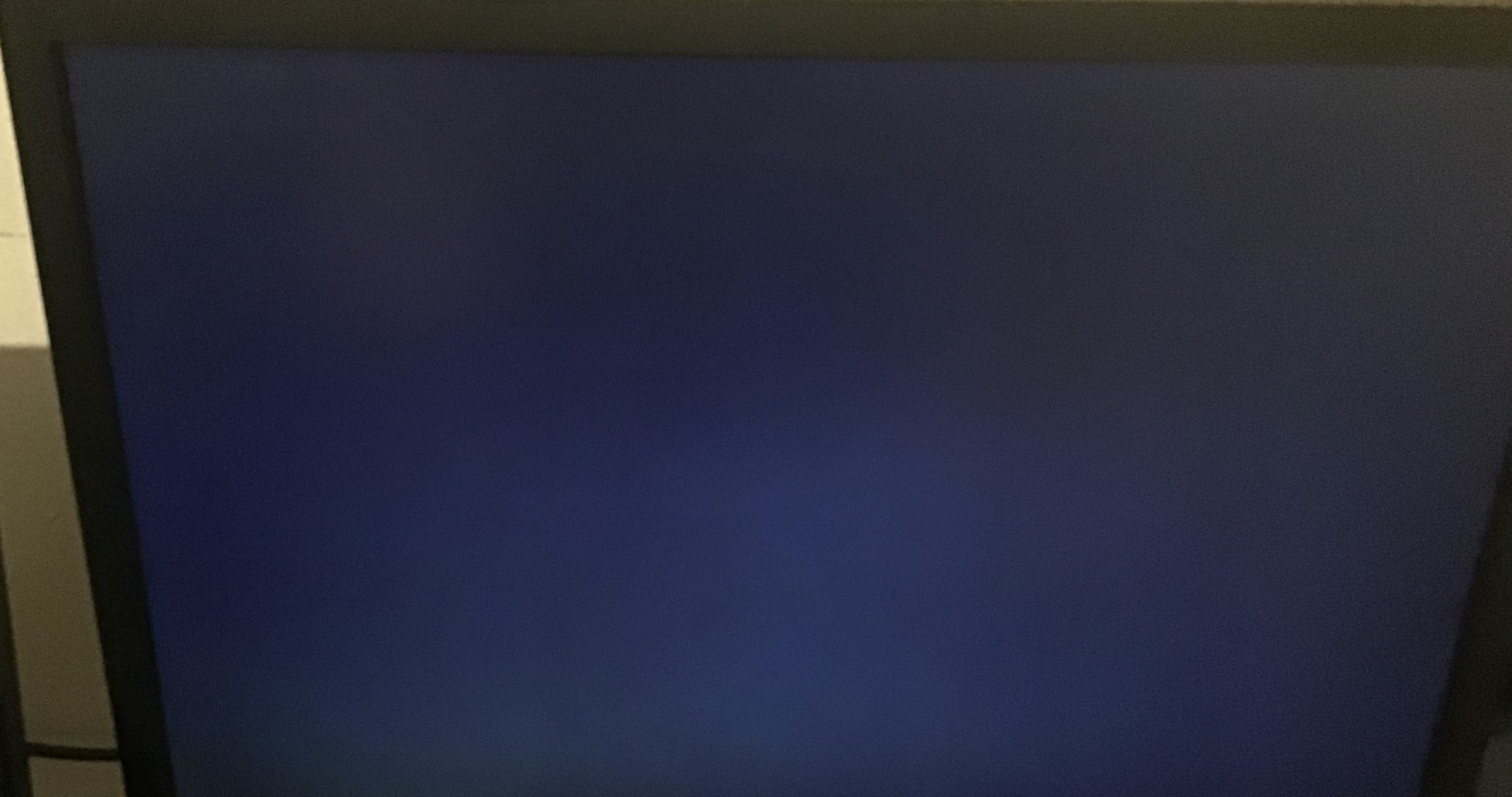

I can’t go on Reddit because it’s blocked on this device but maybe there’s a fix for the black recovery mode screen
