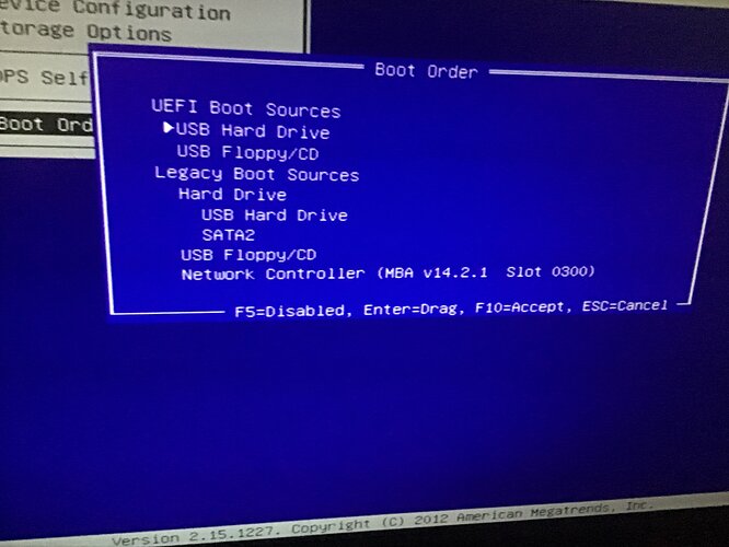

I have got the bios up before but it’s an outdated version it looks like this

Is this right

Yes, that looks right.
