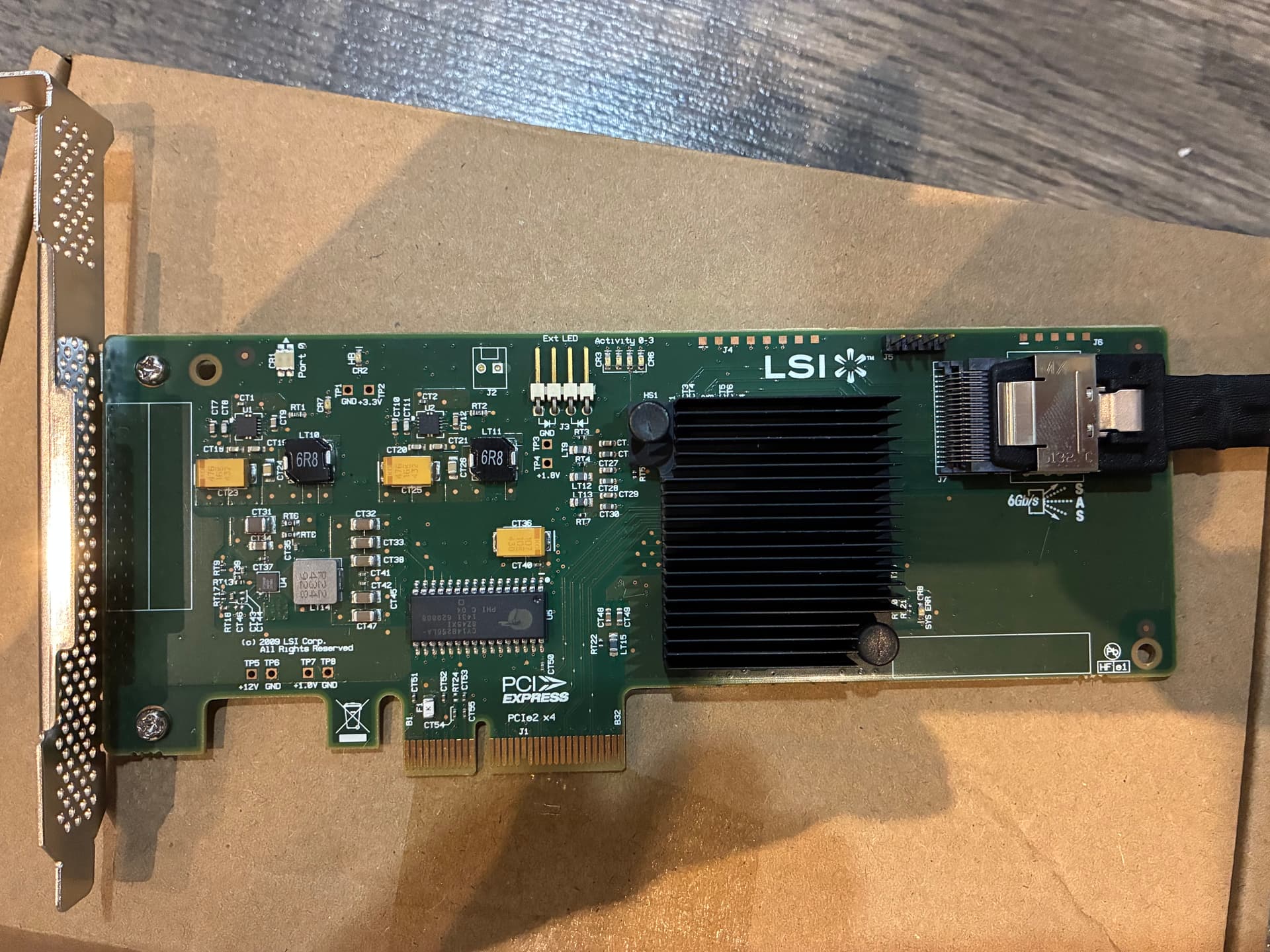

2026-07-10 Update: I bought this controller and it does work.
SAS HBA Card Compatible with LSI 9211-4i IT Mode PCIe SATA Expansion Card, Expander Support, 4-Port 6Gbs PCIe 2.0, HBA Controller with 1x SFF-8087 to 4X 8482 SAS Cable for NAS TrueNAS unRAID
I had two 6 TB SAS hard drives. Both appeared to be new (sealed in static bags).
One works and the other was not seen. Since they are identical models, I believe one hard drive is bad and this issue is likely not the fault of the SAS Controller card.
With the unfortunate exception of this one hard drive the SAS controller card and the other SAS hard drive worked beautifully. Plug n Play. I only needed to format the hard drive and start using it.
Note: I believe this SAS controller card cannot do any kind of RAID. For my needs this is fine.
