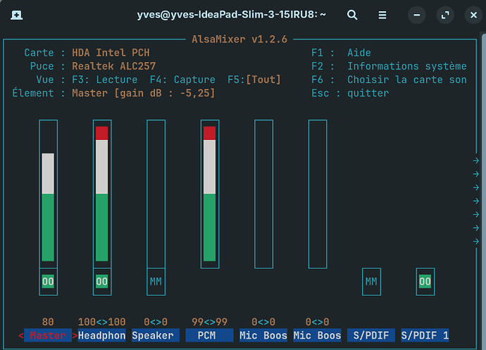

Not sure where is Loopback mode, here's what I have
No. That is not showing up on your system.
Have you tried playing around with Auto-Mute settings. i.e. trial and error, change and see effect, change back if none.
Out of interest, does alsamixer F6 list any other sound cards/devices?
By automute you mean playing with the column 6 in the second picture?
This is what shows up with F6, I'm not even sure if it's one sound card or the same?
Capture d’écran du 2024-08-29 08-22-08
Yes. "Auto-Mut" channel is Automute.
I also see you have just the one soundcard: HDA Intel PCH/ Realtek ALC257.
