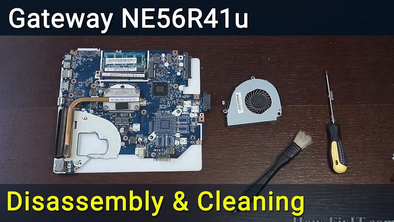

Notebook computers are never fun to take apart:
Using the resource of video guides, you can get the basics of removing the outer case and gaining access to underneath the touchpad. Look for any loose or partially disconnected cables.
What I would do is disable touchpad in config settings then power down. Then disconnect the touchpad cable, plug in the USB Mouse, Carefully boot up the computer and test if the mouse repositions itself.
