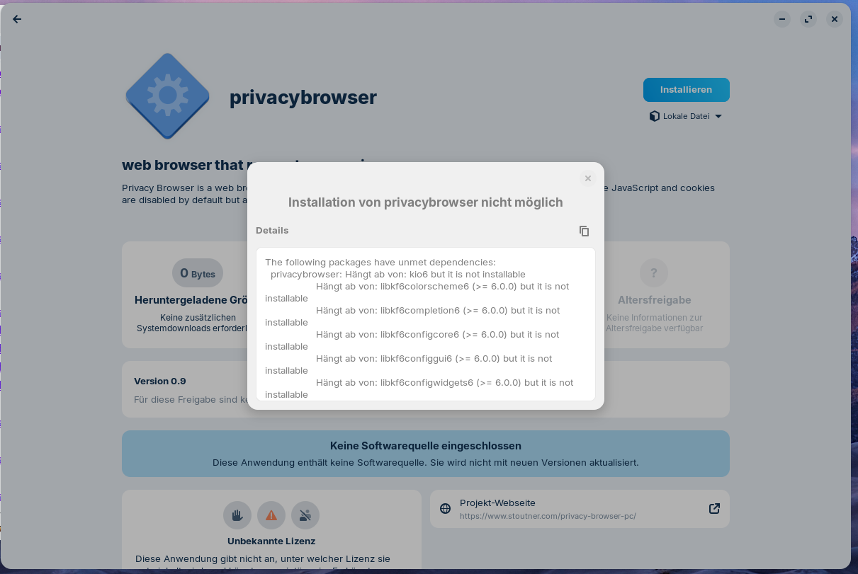

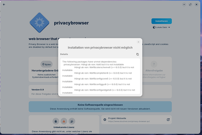

I tested the installation in a Zorin 18.1 Core live session (installed via terminal sudo apt install privacybrowser), there were shown no errors during installation, but the browser didn't launch.
When launched via terminal it showed a segmentation fault.
I found no sites that this bug was solved in version 0.5 which Zorin18/Ubuntu 24.04 uses, only in higher ubuntu versions (in 25.04 plucky puffin). The .deb file from the browser seem to work without problems.
In my test, the installation of the latest 0.9 version of the browser didn´t work because of missing dependencies, also not 0.8 and 0.7, but with 0.62 it did work.
