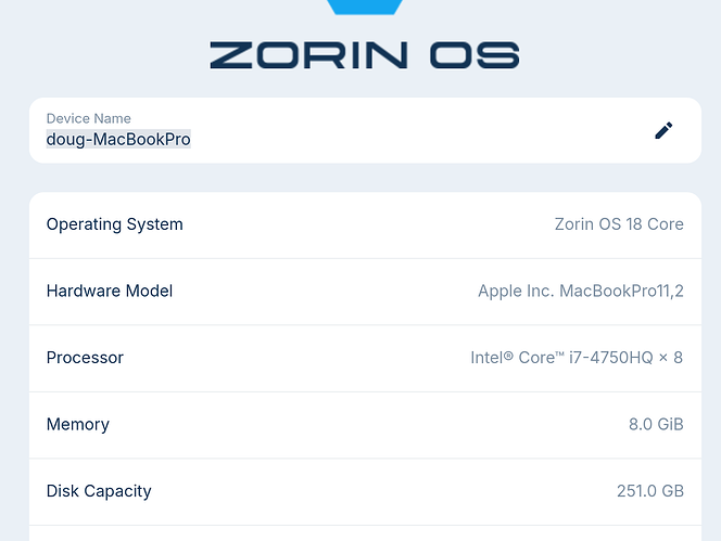

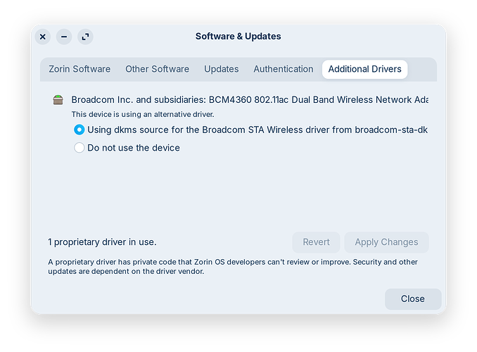

I'm trying to install a WiFi driver on my new installation of Zorin OS 18 Core but get error messages.
Additional drivers:

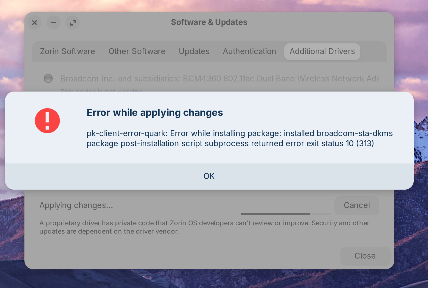

Error message:
I am able to install the drivers on this same computer running LimeOS.
Any suggestions? Thanks, Doug

In terminal, can you please show the verbose output of
sudo apt install broadcom-sta-dkms
I bet it will complain about the 6.x kernel...

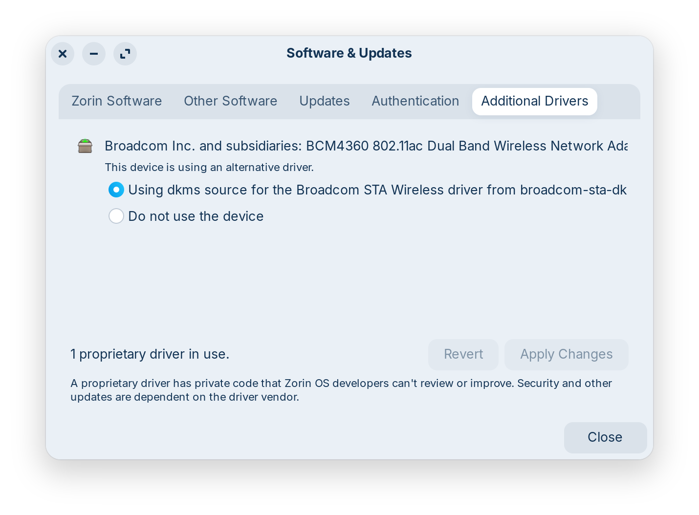

Now I'll reboot to see if WiFi appears...
After rebooting still no WiFi.

I think I've got it working. I found this article on AskUnbuntu and went through it step-by-step and works now. My particular laptop is a 2013 Macbook Pro now repurposed to try out various Linux distros. I'm glad we solved the problem; this is my favourite so far.
Thanks, Doug
Wow.
We were focusing only on the broadcom-sta driver, because that is what the system reported... we did not think to try firmware-b43-installer...
