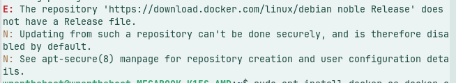

I'm trying to install WinBoat, and it says here in pre-requisites that I need to have Docker, Docker Compose v2 and other things installed for it to run properly. so I tried installing Docker but I first need to set up Docker's apt repository, but I have this issue in terminal and I can't go further with the process because of it. what do I do? I don't know the commands necessary to disable this via terminal

Your output shows that the repository you are using lacks any files for the Noble (Ubuntu 24.04) series.
I do not recommend following the A.I. generated content above.
Instead, remove that repository as it is unneeded. In Zorin OS, the packages are already in the repository.
Once you have removed that download.docker.com/linux/debian repo. Once removed, in terminal, run:

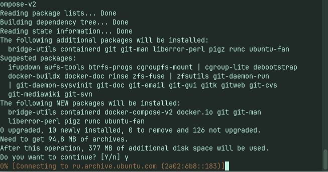

sudo apt install docker.io docker-compose-v2

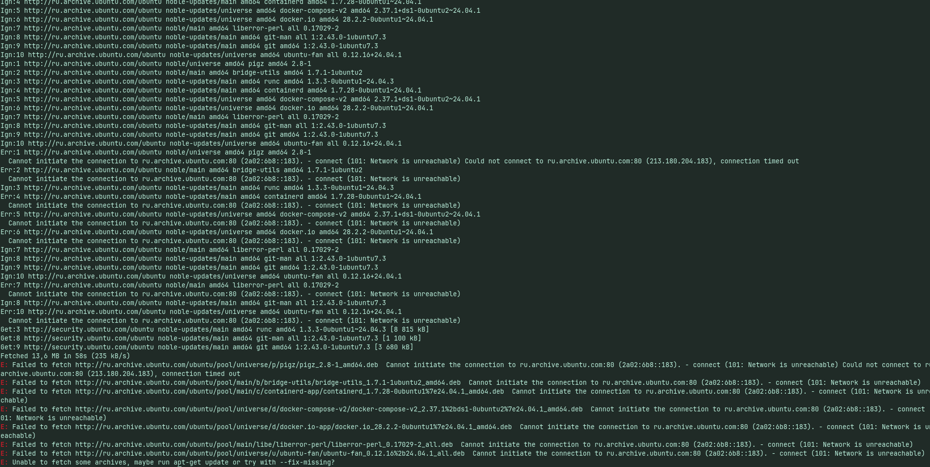

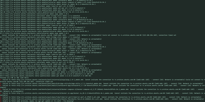

okay so I did exactly what you said but I think something broke
In Software & Updates app, switch "Download From" to Main Server.
It looks like the Russian mirror supplying the packages is unreachable...
Once done,
In terminal run:
sudo apt update && sudo apt --fix-broken install
Then
sudo apt install --reinstall docker.io docker-compose-v2
