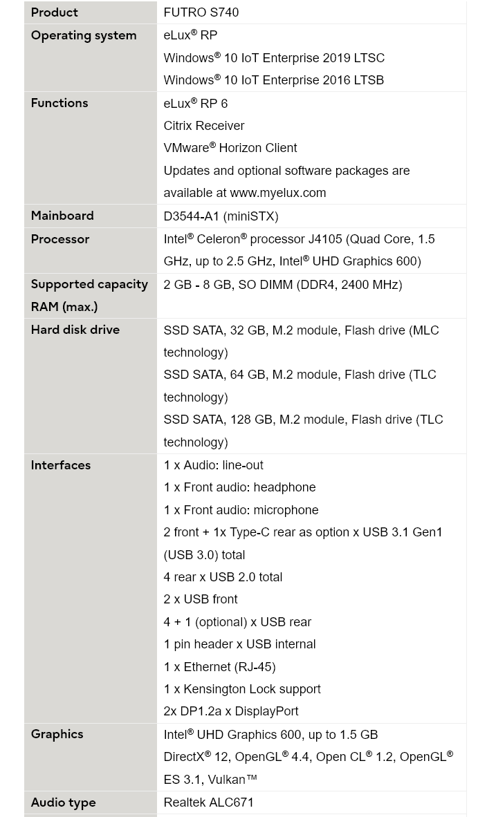

EDIT: I have searched and found tech spec for that PC. Attachment.
