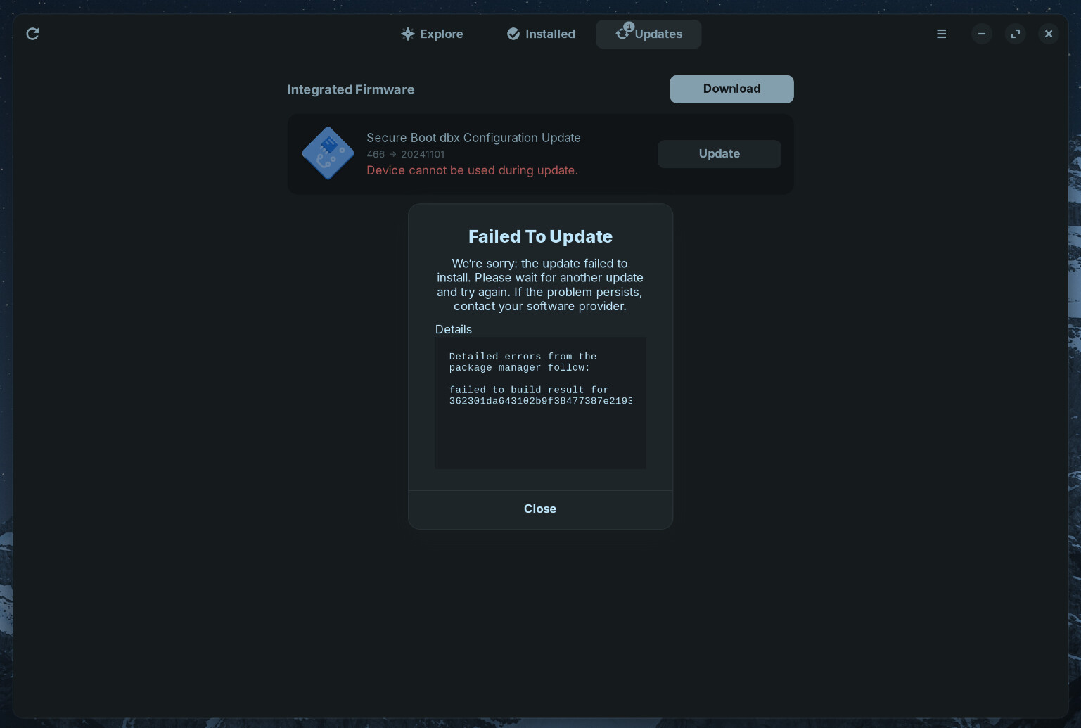

It looks like this firmware update might have been getting stuck on your installation. To try and resolve this issue, please first install the latest updates from the Software Updater or by opening the Terminal (Ctrl+Alt+T) and entering these two commands:
sudo apt update
sudo apt dist-upgrade
After installing these updates, restart your computer before continuing.
Next, it should be possible to manually install this firmware update and clear the pending database afterwards – so this message shouldn't appear again – by opening the Terminal and entering these four commands:
sudo fwupdmgr refresh
sudo fwupdmgr get-updates
sudo fwupdmgr update
sudo rm /var/lib/fwupd/pending.db
Afterwards, restart the computer to apply the changes.
If this didn't resolve the issue, could you please post the text output after running the four commands (directly above) in the Terminal? If possible, please also include the text output from the following command as well:
fwupdmgr get-devices
In addition, could you please let us know if you've made some prior modification(s) to Zorin OS after installing it to your computer? These modifications may include one or more of the following:
  • adding third-party software repositories to your system
  • manually editing any system files
  • executing unofficial scripts/commands
This information would help us to troubleshoot the issue.
Thank you, Artyom.
Thank you very much Artoym.
Thanks to Artyom for responding. However I do feel that Secure Boot has become a liability having read the flaws present, the fact that Microsoft have only fixed one cve issue and not the second, still leaving hardware vulnerable. We cannot control what Microsoft do, but I wonder if disabling secure boot and instead apply a strong Password that has to be entered before the system boots would be a better temporary solution for dual-booters until Microsoft gets its act together.
Vulnerabilities can take time to be patched - always. That is a risk we all take - including undiscovered vulnerabilities.
Secure Boot can still be beneficial to dual boot users - these vulnerabilities require direct access to the computer (though one does acknowledge a possible remote vector).
Issue not resolved. Text output below (updated).

You should do a Reboot.
I did/have rebooted; I just initially went 'no' to capture all of the text.
Could you please let us know if the issue still persists after restarting your computer now?
If so, could you copy & paste the error message or upload a screenshot of it here?

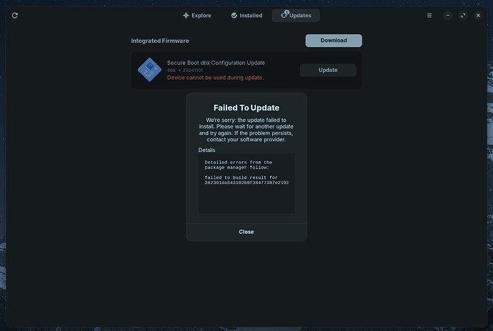

I went through the same process, this time selecting yes when prompted to reboot. Snip below:
Could you please try running these two commands in the Terminal:
sudo fwupdmgr refresh --force
Finally, please restart your computer once more to try and resolve this issue.
If the message still appears in the Software store after this, could you please let me know the make & model number of your computer or its motherboard (if it's a self-built PC)? This would help us to investigate the issue further.
