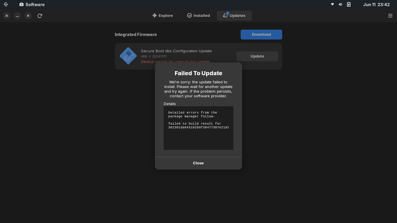

I started getting a warning about problems with secure boot dbx, which really caught my attention because it had never happened to me before.
I tried disabling secure boot mode in the BIOS, but my Asus Prime B450M-AII motherboard doesn't allow me to do so (it appears dimmed).
Does anyone know how to fix this? I found some pages that discussed the topic, but they were too technical, so I didn't understand a thing.
Thank you very much in advance.
