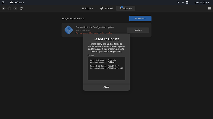

I keep getting a error when trying to install latest update.
Please help me fix this.

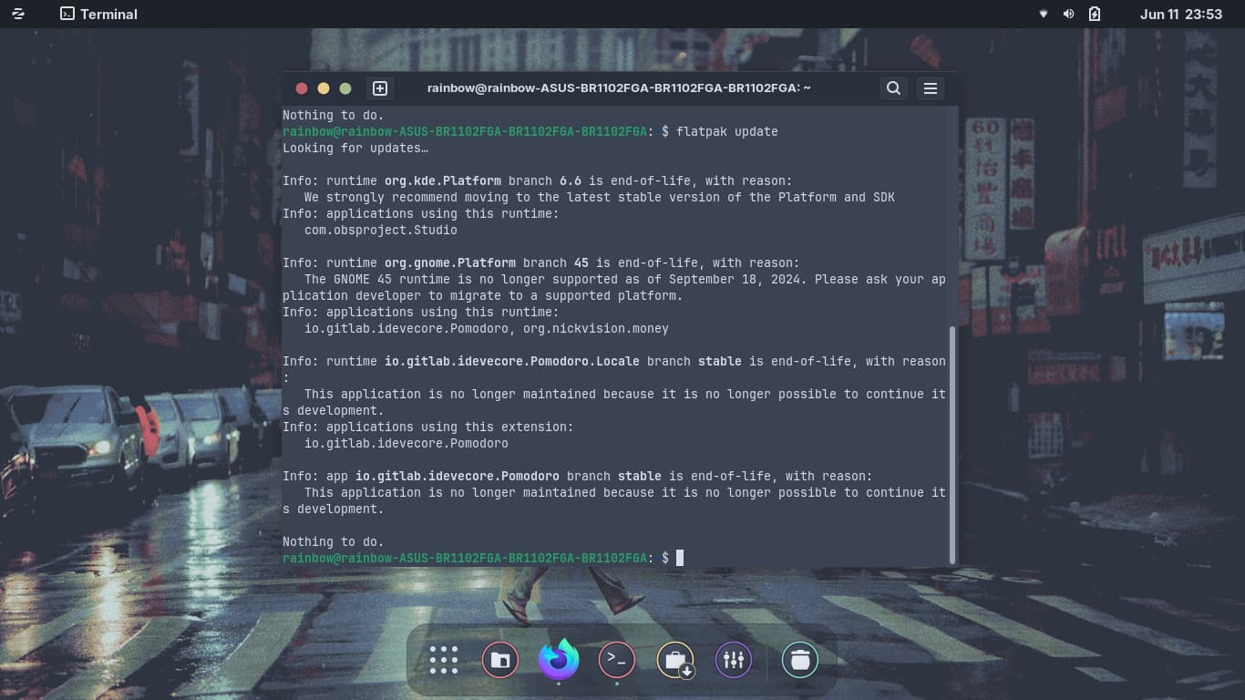

Have you ensured all your flatpak packages are updated?
In terminal, flatpak update
Update i ran flatpak remote-add --if-not-exists flathub https://flathub.org/repo/flathub.flatpakrepo
and then flatpack update and it installed update
For the flatpak's right?
What about the original Secure Boot DBX error? I was actively typing about this when your post above posted.
yea my original problem is still unsolved
Ok, can you reboot, then disable Secure Boot in BIOS.
Reboot (again...) Then enable Secure Boot ( I am assuming you are using it).
Then test - that should reset the Secure Boot grip on the DBX.
This alone might be enough. But if not, try
sudo fwupdmgr refresh --force
It currently says disabled
Should I enable it?

I’m still getting same error after doing what you said in previous message. I’m gonna try enabling it and see if I can go from there
Similar issue has been reported by an user few weeks ago. You may follow their conversation and try the solution they shared.

Besides that: You have seen that there are some End-of-Life Notes in Your Terminal?
I wonder if this is the issue?
