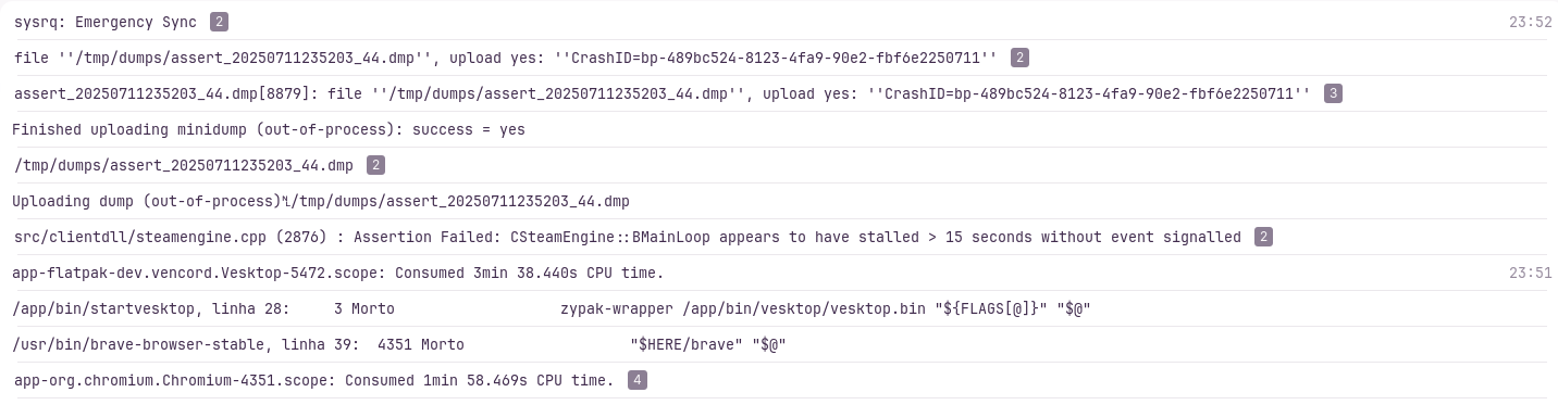

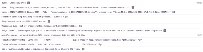

Alright, it froze again. These are the most recent logs, the one beforehand is 10 minutes early compared to these.
jul 11 23:52:03 VinPC steam[2125]: src/clientdll/steamengine.cpp (2876) : Assertion Failed: CSteamEngine::BMainLoop appears to have stalled > 15 seconds without event signalled

And this is what the Logs program gives me on the most recent crash.
