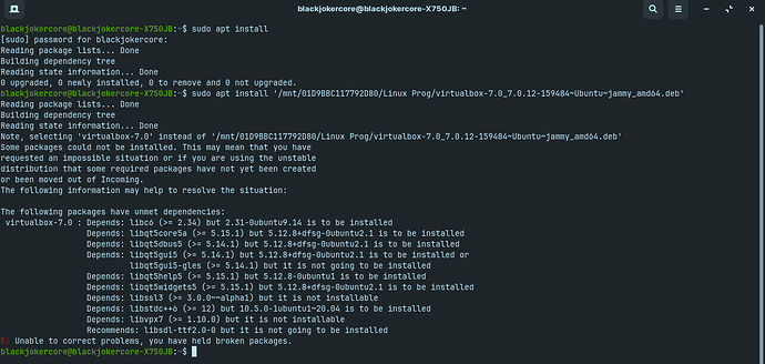

I needed to use windows OS in a VirtualBox so I tried to download orecal and I got this error
it;s not my 1st time to get this error after downloading a deb file and trying to install it

and I got
root@blackjokercore-X750JB:~# rm /var/lib/apt/lists/partial/*
rm: cannot remove '/var/lib/apt/lists/partial/*': No such file or directory

Could you open the Terminal, and here type:
sudo apt install
with a blank space after "install", and then drag your *.deb file on the terminal?
So you'll see something like
sudo apt install /home/nicolo/Downloads/debfile.deb
and then press enter?
Aren't sudo apt --fix-broken install, sudo apt-get update --fix-missing or sudo apt-get update --fix-broken suitable? BlackJoker, don't enter them, I just proposed them, I'm not aware of consequences
That is usually the solution when you see the held packages message.

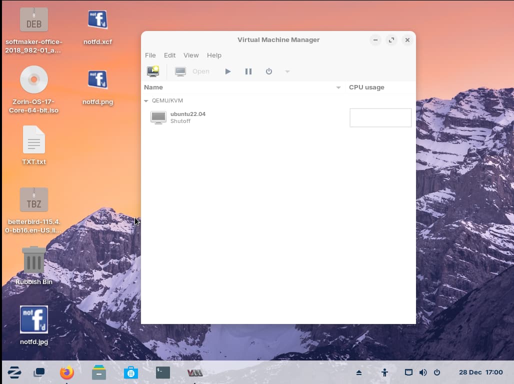

No issues with my VM of Zorin 17:
If you are running Zorin 16 then choose the Ubuntu 20.04 from that page.

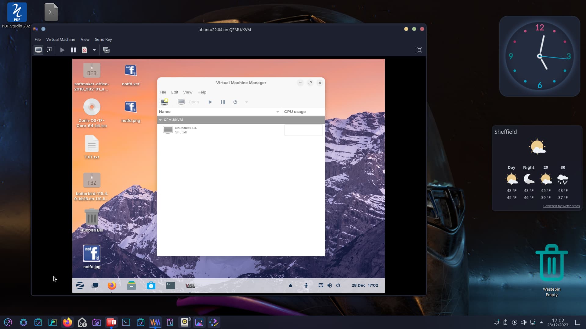

But for me it is virt-manager ... every time!
It is what I used to capture Zorin 17 as a VM inside of KDE neonuser in order to create the Unofficial Manual for Zorin 17 Core.
