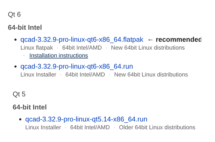

The image below is a screen capture of the QCad download files that I installed from. Flatpak and various flavours of Qt based"Linux Installers". They needed to be flagged as executable with file properties and then "Right clicked" run as executable.
