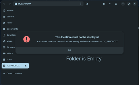

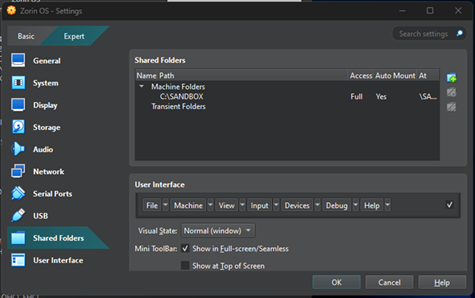

Hi, I am new user of Zorin OS, installed with Windows VirtualBox and shared a folder named SANDBOX below.
Later, when try to access the shared folder via Zorin OS, I received error below.

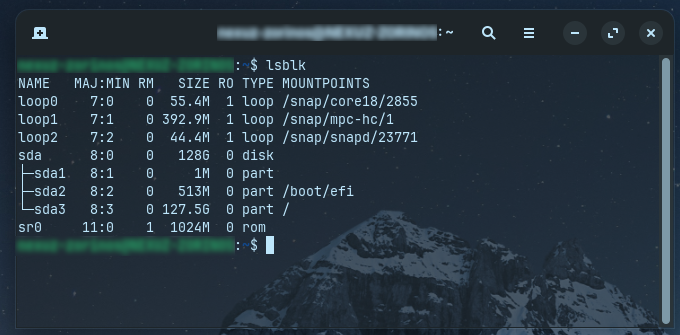

If this doesn't make any difference it might just be an issue with permissions. Try running this in a terminal and share the output:
lsblk
Thanks, I tried your suggestions but result still the same.
The lsblk result:
Thanks for the feedback, I already submitted to VirtualBox forum HERE for references.
According to the output of the lsblk command, there's nothing more than the drive where Zorin OS is installed.

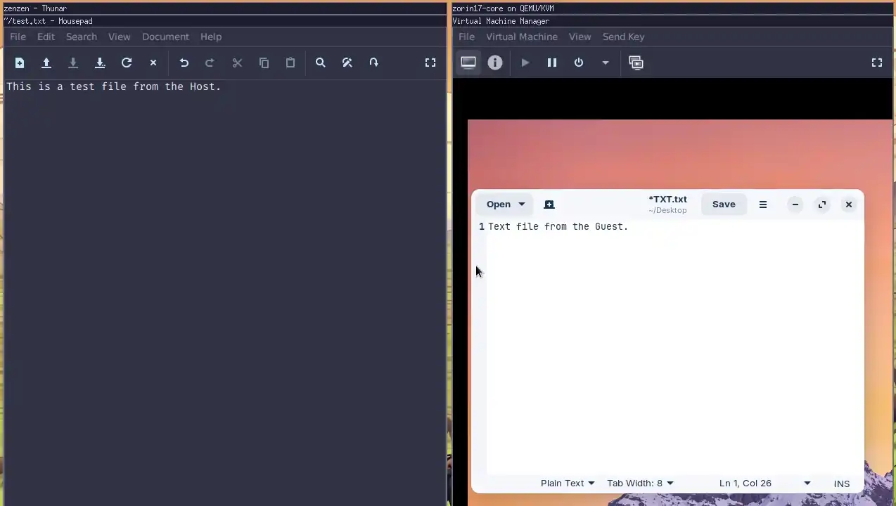

I haven't used VirtualBox in years; I don't remember if you were supposed to enable file sharing somewhere. For reference, with KVM you need to make the drive available to the guest first, and the mount it.
But everything else works fine i.e., clipboard, file sharing, and sharing files once the mounting is done. Although I just noticed that drag & drop seems to work as some sort of download, or at least it opens the Downloads folder and drops the file there for some reason :thinking:

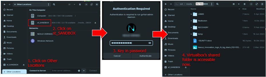

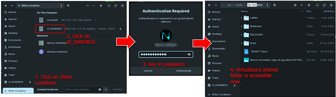

Just found the solution to access VirtualBox shared folder as described below:
I also tested the latest version of Ubuntu 24.04.2 LTS where initially it behaved the same as Zorin OS v17.3 where the VirtualBox's shared folder is prohibited due to permission problem as well as the drag-n-drop and copy-n-paste file are not feasible.

Oh, you're right. I can't copy files entirely, just text. Although the drag & drop works fine for me. I'll have to try with other images to see if it's something specific or more generalized :thinking:
