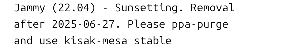

The support for the kisak mesa fresh ppa for Jammy has ended (this is the ubuntu version which Zorin is based). You will need the stable version of the mesa ppa.

sudo add-apt-repository ppa:kisak/turtle
sudo apt update
sudo apt upgrade
