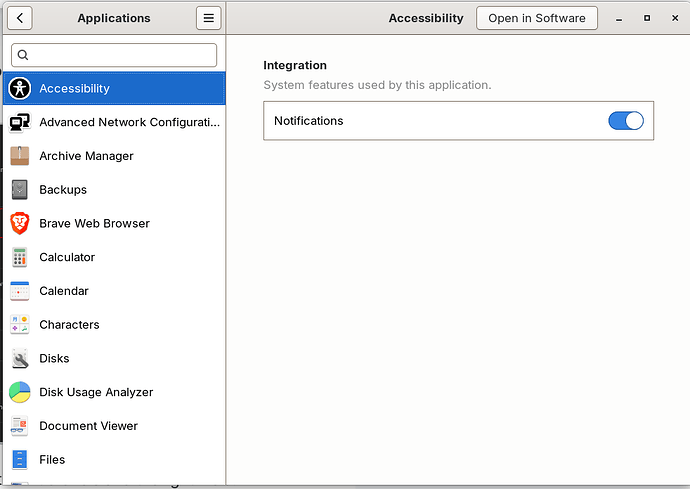

  2. Look if the ''High Contrast Mode'' in Settings>Accessability is active. If yes turn it off:

Light mode is selected in Quick Settings. But I couldn’t access High Contrast Mode in Settings>Accessibility (see screenshot), but turned it off from the tool bar. Then went in and re-set Zorin Themes to Blue and Light Mode.
