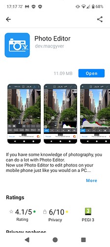

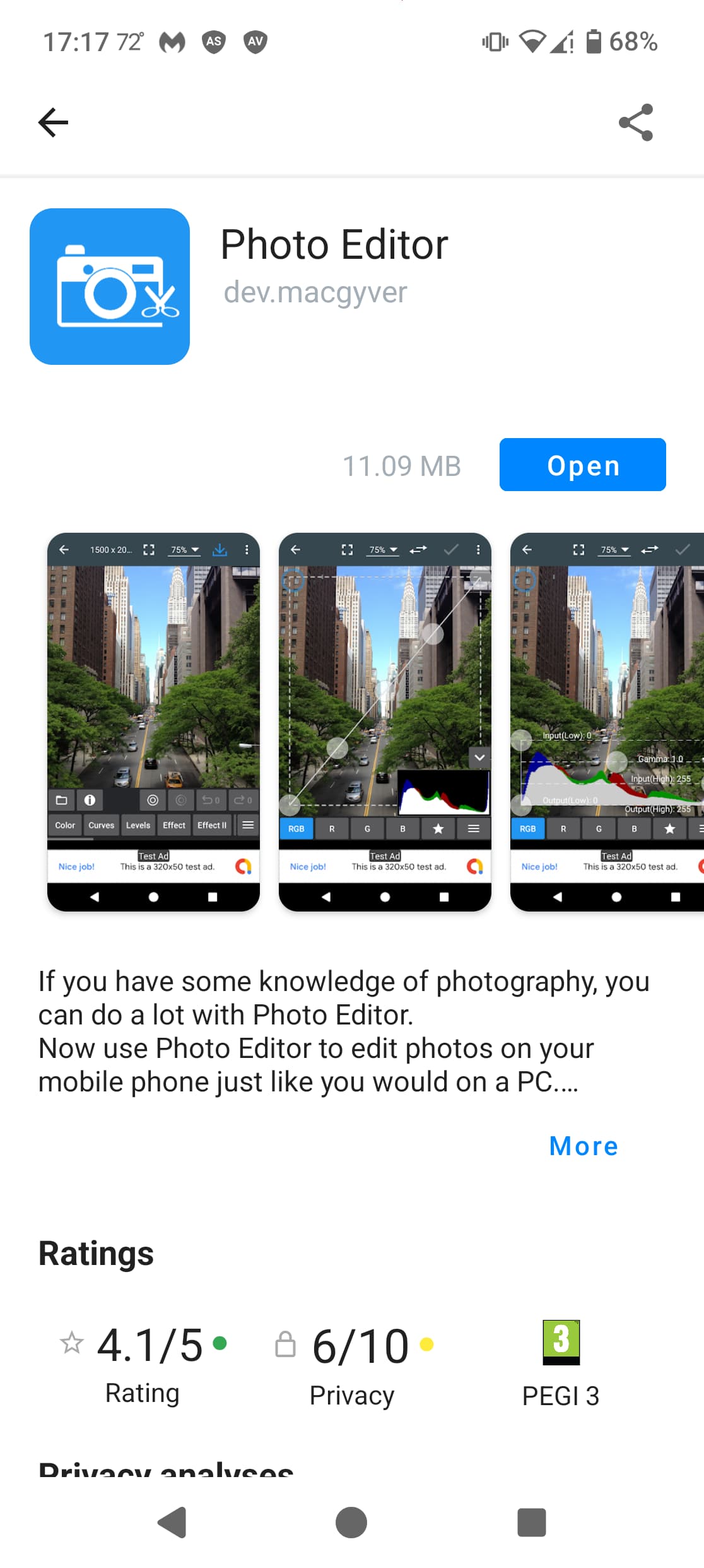

The forum limits images to 1 Mb. If you are using your smartphone camera with High Res, edit it in 'Photo Editor' if using Android:
