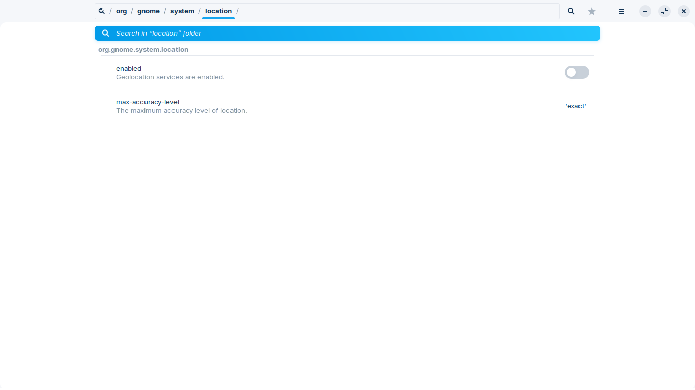

Aravisian wrote few years ago that the location services can be disabled in Zorin lite by installing dconf editor
sudo apt install dconf-editor
and then go to
/org/gnome/system/location
and toggle off the slider at "enabled"

But even once it's started, and Redshift is working, the slider in dconf Editor appears to be toggled off.

In the dconf editor, turn on the slider or replace "false" with "true" in the gsettings terminal command.
