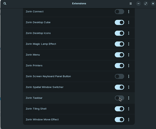

It's better to disable it because it use many dependencies shared with Zorin desktop as you can see on you screenshot...
I had always thought of extensions as standalone packages, similar to AppImages.
not this kind of extension, many Zorin extensions are integrated to zorin-desktop (if you open extension manager you will see you can't remove them)
Normally they are removable but the Zorin One's are like System Components. So, disabling is the better Option.
Or: You could try to go to /usr/share/gnome-shell/extensions and there delete manually the Extension Folder. And hope that it doesn't break the System.

Go into extensions then go below u should get zorin taskbar and then disable it. There is no current way to completely remove it but this should solve your problem

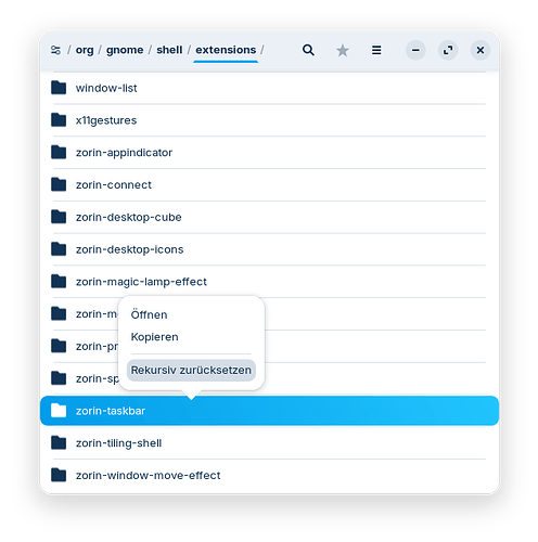

Instead of running the command you can also use a right-click on the extension in dconf-editor and select "reset recursively", then click on apply ( :white_check_mark:)

The reset function is really helpful. You can reset all settings of a gnome extension by right-clicking on the extension name, or you can reset the individual items by right-clicking on the item.
