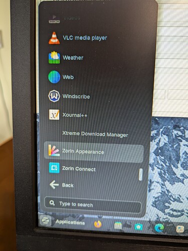

So I suppose I installed app Xtreme Download Manager twice and ended up with 2 entries in Zorin icon/Applications and one in Installed Applications - I uninstalled the latter, but am left with one entry in Applications. Any idea how to remove it?

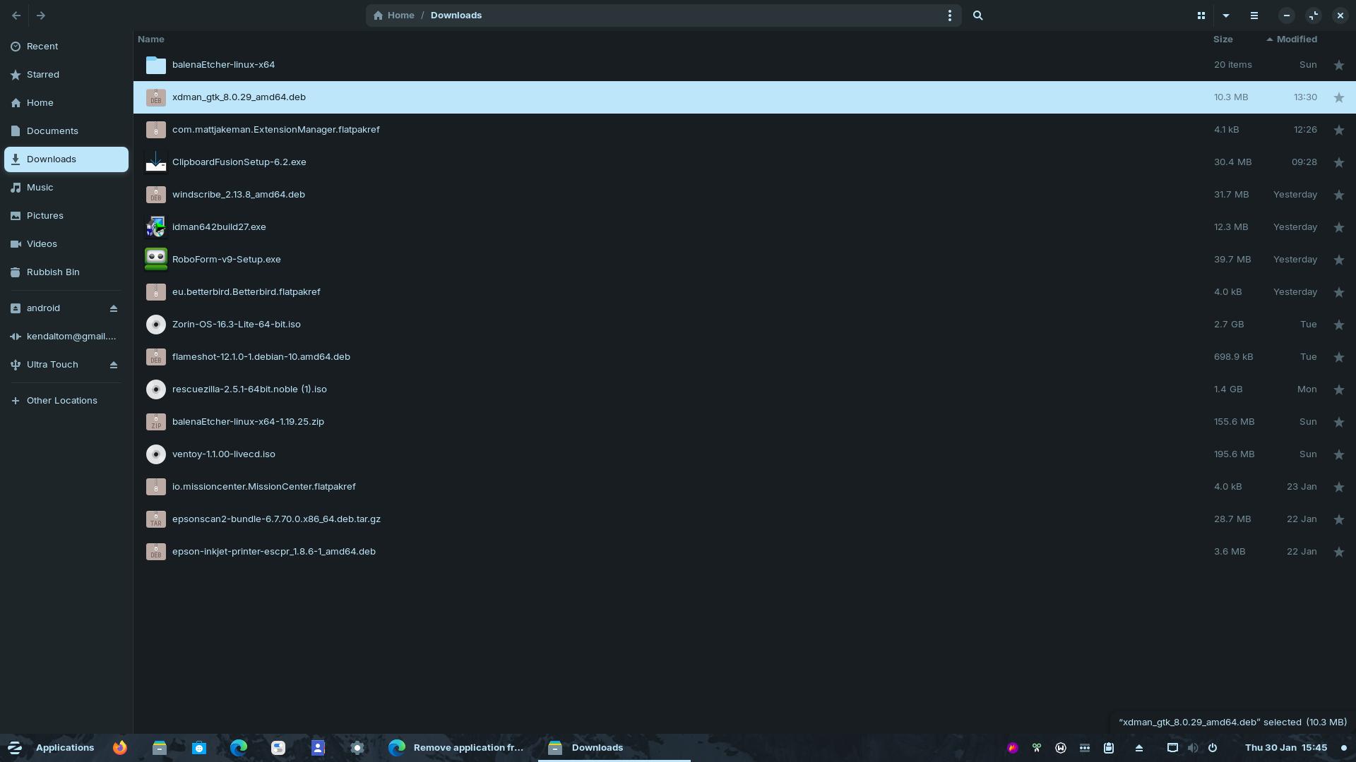

Hi, @Ponce-De-Leon. I'm not sure - I think I tried the file in my downloads once (see shot)
, though O'm not sure where it came from.

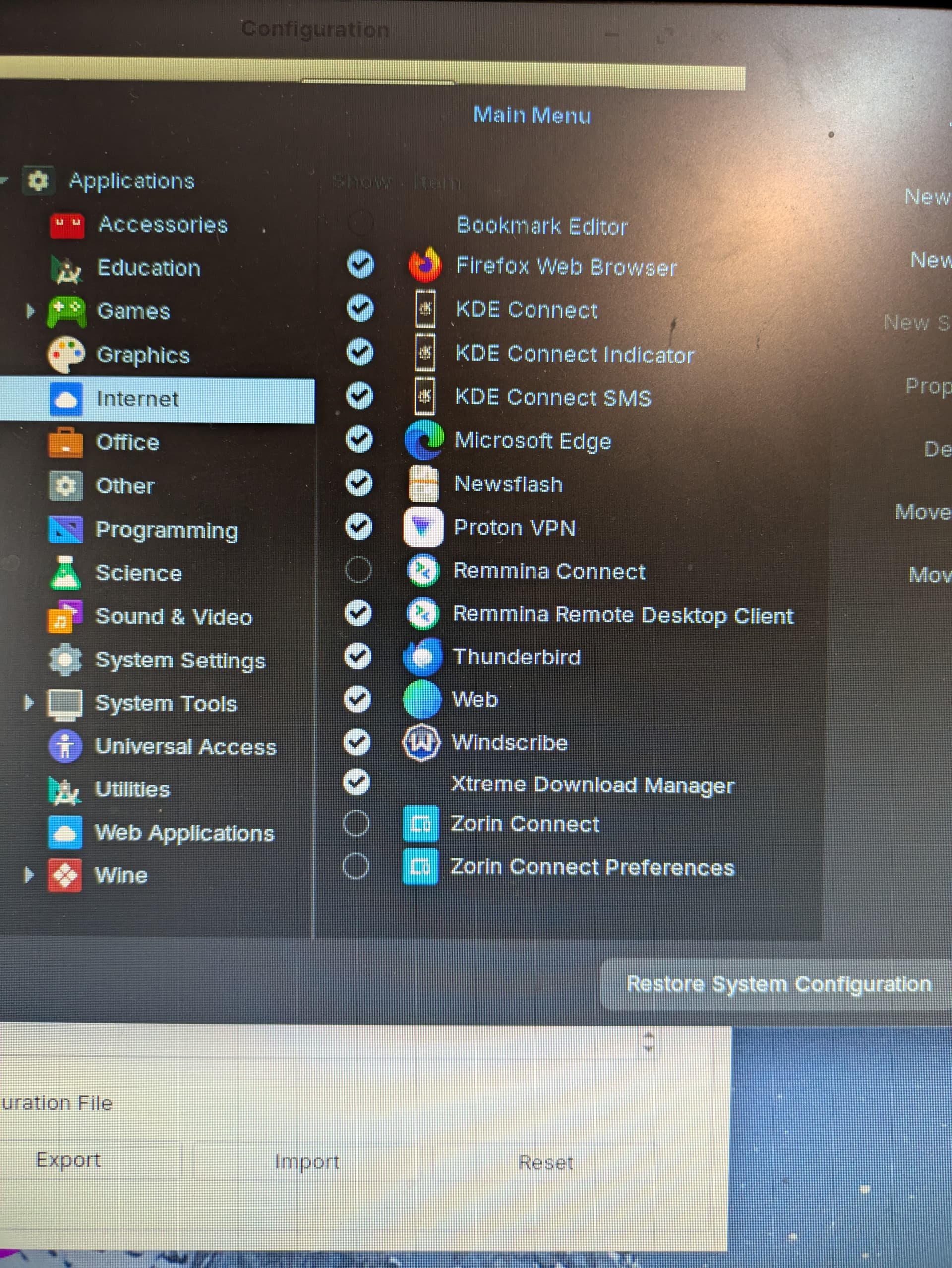

Which is the Main Menu?
Because You have a .deb File, You could try it with GDebi. It is a Program to install .deb files. But You can use it to uninstall Programs, too as far as I know.
Because of Main Menu: It is a Program that comes preinstalled. Simply search it in the Search Bar.
Tried the GDEbi app and it uninstalled the app, but it now shows up in Zorin icon/Apps with the name bar, but no longer the icon.
Main Menu shows it without an icon, but Properties doesn't show anything. Delete it here?
Before deleting: Could You post a Screenshot of both?
And when You click on ''Properties'' in Main Menu for the Entry what does it show You there?
Nothing - nothing happens
I think then You can delete it. So, click on the Entry and on the right Side click on the ''Delete'' Button.
