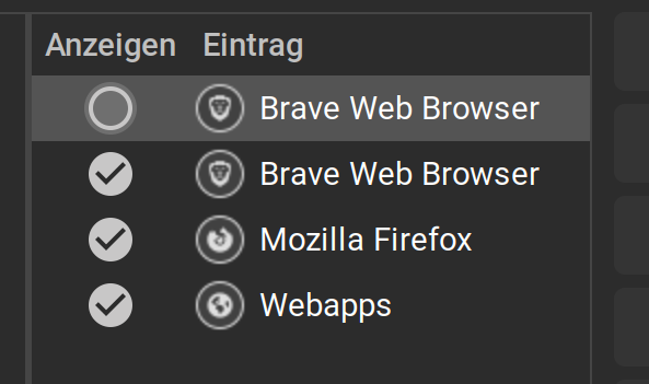

In Main Menu, You must click on the Entry so its highlighted:
And then click on the ''Delete'' Button.

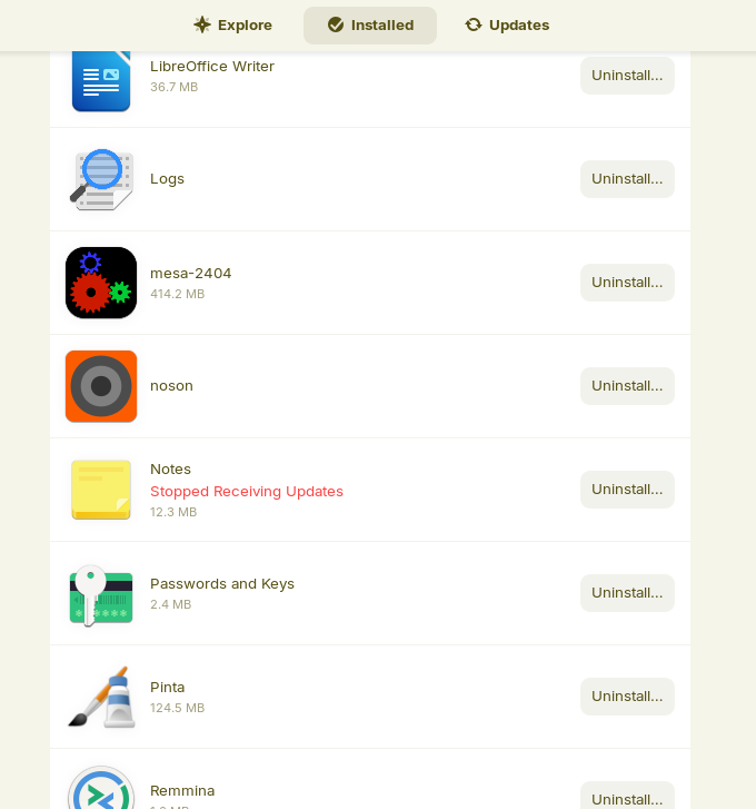

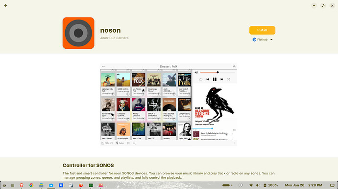

But, I took the easy way out, Delete! Thanks Ponce -De-Leon for the encouragement! And problem solved, almost. I say almost because there is still the Noson app icon left in Software > Installed with an Uninstall button that as before does nothing. Clicking on the app opens Loading App Details page where you can click the Install button!

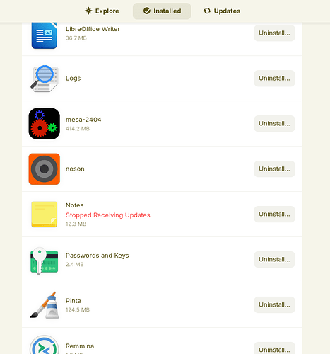

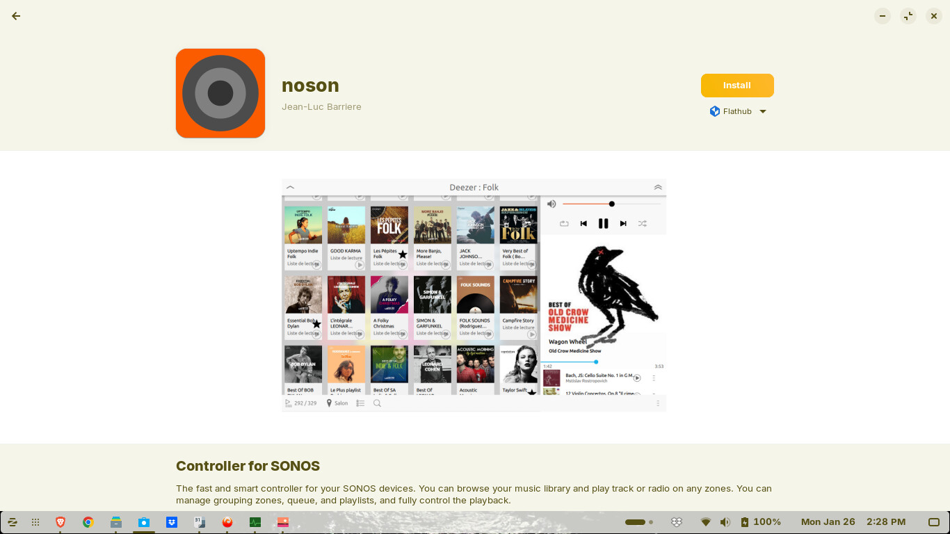

Can You make a Screenshot of this?
I'm assuming you mean these two:
The first shot is Software > Installed apps & the second shot is the Apps Detail page after clicking the icon. I did notice this time that as soon as this page opens it displays an Uninstall button which almost immediately changes to Install!
As far as I can tell this is the only Noson app icon left and it apparently does nothing which is ok. My main interest was trying to stop the update attempts which so far appear to have stopped!

I'd deleted Noson from Main Menu a while ago and I've looked through every single line a few times, I don't see it any where else in Main Menu. The only place it still shows up now is in Installed Software, still with Uninstall button that does nothing. And still, if I double click the icon it opens the Software page (photo) that allows you to Install the app. And still, when that page opens it initially opens with an Uninstall button that quickly changes to the Install button!

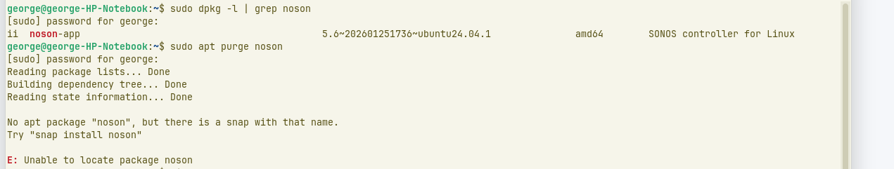

Results of dpkg -l grep noson & apt purge noson:
Also follwed up with suggested cmds killall gnome-software, appstreamcli & reboot and the sadly the Noson app still shows up in Installed Software.
Please note that cmd dpkg -l | grep did find this:
ii noson-app 5.6.........ubuntu24.04.1 amd64 sonos controller for linux
So it appears the nonon app is located so where but I can't tell where, hopefully someone can!

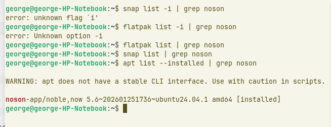

Results of snap & flatpak list:
Apparently -i doesn't work so I tried some other cmds I found and "apt list -- installed" found essentially the same Noson app that cmd dpkg -l | grep found.
Please let me know any of this makes any sense to you or questions, etc.

Sorry that I gave the wrong commands.
What is shown when you enter
sudo apt purge noson-app
There stands noson-app as Package Name. Try it with that:
Is it possible that you have added a ppa to install the noson-app? Because the noson-app is not in the ubuntu repository.
Use the sudo apt purge noson-app command to remove the app and then remove the repository from software-sources and then update the system.
