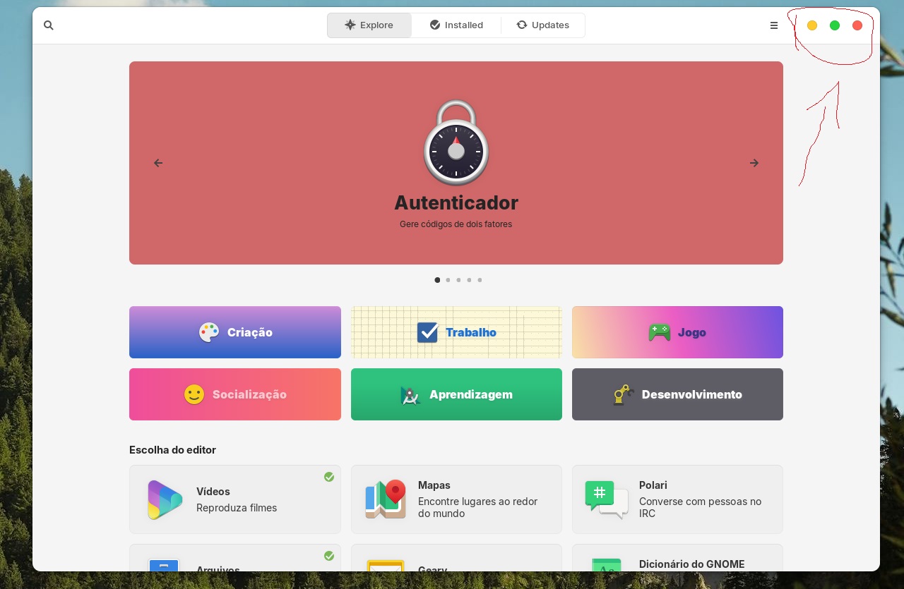

boa tarde pessoal, estou usando o zorin 17.3 dai resolvi mudar o tema para o MAC mas agora nao estou conseguindo tirar, vou deixar uma foto circulado com uma fecha em vermelho para voces verem, quero tirar esse tema, por favor me ajudem

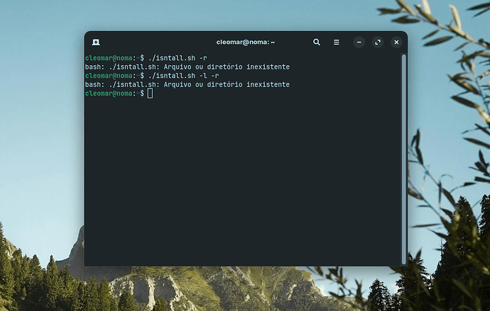

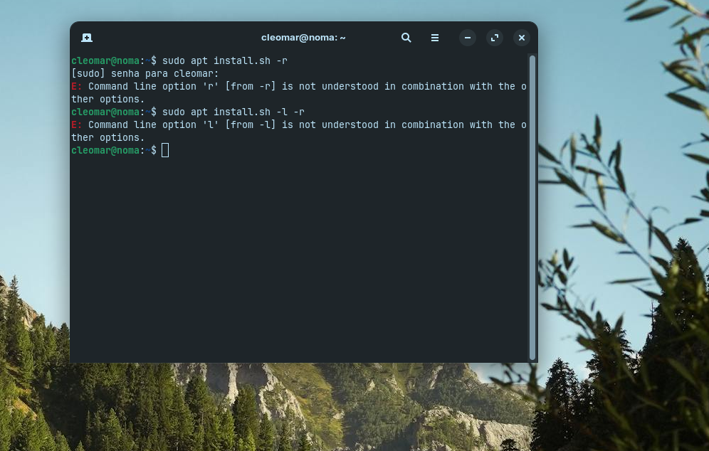

olha que ele me retorna quando digito os comandos... vou deixar um print...
Enter
./install.sh -r
Don't use sudo apt.
Sorry! Yes, please look on @Forpli's Comment. I forgot ./ before it. I will correct it.
boa tarde, vou te mostrar oque retornou agora, bom acredito que estamos quase la, me ajuda ficarei muito agradecido... quero remover o tema, as letras fica tudo transparente
, muito difícil de ler etc
You wrote isntall but it have to be install

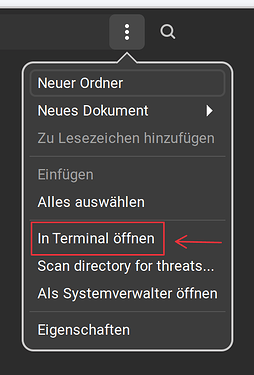

You'll want to make sure that your terminal window is actually open to the location of the script (theme folder) otherwise it won't know what file you're talking about. So if you have a folder window open, you can right click the empty space and select "Open in Terminal" and then do the commands from there to be sure it's at the right location.
sim verdade, obrigado por me corrigir, mas eu fiz certo agora e me deu a mesma mensagem de antes...
Probably the command only works when you are in the directory where the script is saved as @applecheeks37 wrote.

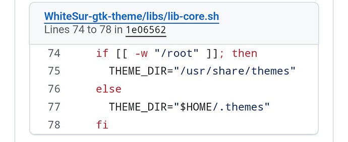

Search in your file manager for whitesur-gtk-theme at ~/.themes (or if you have installed it with root rights "sudo" then at /usr/share/themes).
Click on it with right mouse and choose open terminal here. Then enter the command again.

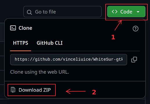

Okay, because I don't know how You have added the Theme and in the Expectation that the linked Theme from @Forpli is the right one, here a Step-by-Step Guide:
First go to the github Page what @Forpli has already linked. There You find over the List at the right Side a green Button called ''Code''. Click on it and in the Dropdown Menu choose ''Download Zip'':

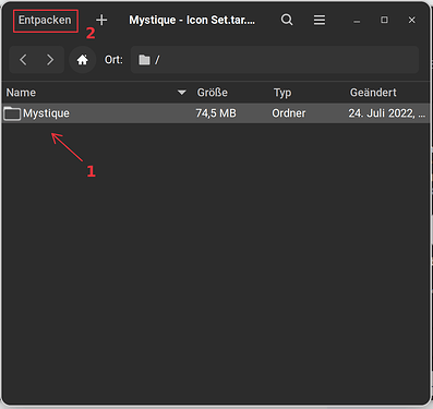

Download the Zip File and save it on Your Desktop. Then double-click on the ZIP File and in the opening Window, You single-click on the Folder inside and then extract the Folder on the Desktop. Here an Example with another Content:

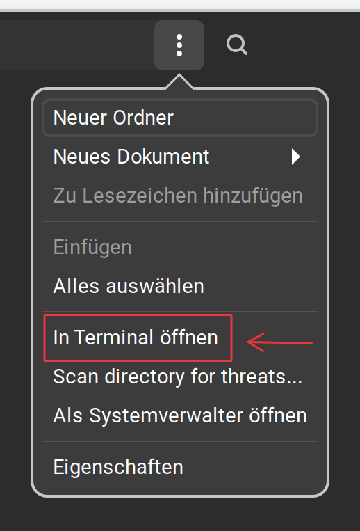

When the Folder is on You Desktop, open the folder and You see a couple of files. there is the install.sh file, too. Now go at the Top of the Window where the Path Line is. Right at the End of it, there are 3 Dots. Click on it and choose the Option ''Open in Terminal'':
Then the Terminal will open and it is opend with the Directory Path. And now, You can use the Commands ./install.sh -r and ./install.sh -l -r to delete the Theme. After that make a Reboot.
